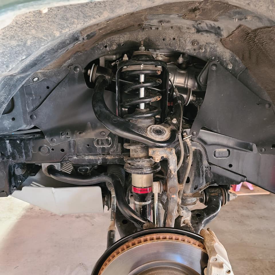

Recently ditched my Cornfed 2" front spacer and went with the Icon 13" 650lbs coils! Result is an inch of lift less than Cornfed 2" fronts. Got an alignment and very happy with the ride. Seems softer over large bumps (than the spacers) and yet stiffer cornering with the 650lbs coils. As an FYI, Stock coils are 12.6" and 600lbs.
With cornfed I was 22.5 and 23" from hub to fender, and now 21.5 and 21.75". (I used one of the small top plate spacers to help level) Rear is lifted with the 1" eibach coils and sits quite even, tires are 285/65/18.

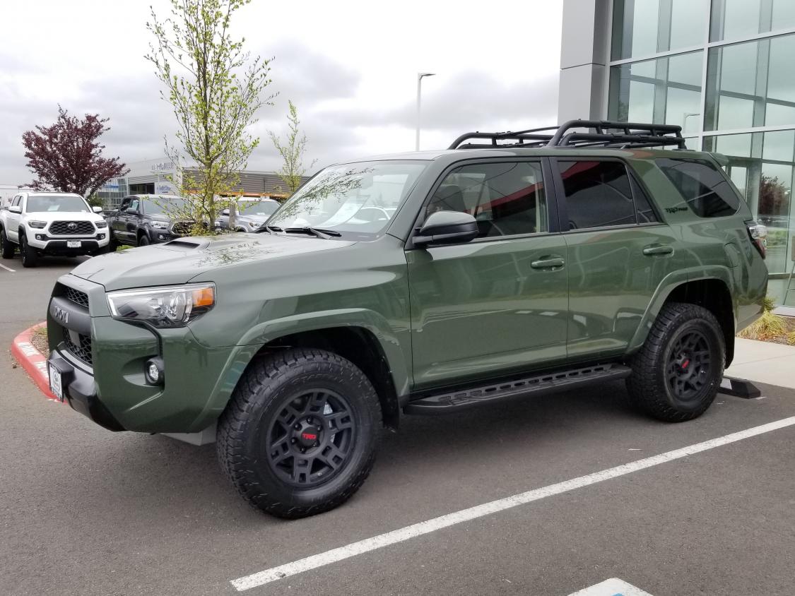

Hi y'all. Just picked up my AG last week. Only mod thus far - Morimoto Elite HID kit in the low beams. It's currently in the shop getting tint and front end PPF. Future mods include swapping out the Pro roof rack for a standard one with black rails and a front leveling kit. Either the Eibach coil springs when they come out or maybe the Westcott Designs spring perch.

Looking good Conrad!!
I could not help myself. Good Pic.

I eventually want to ditch my spacers and upgrade the coils in the front and rear.
I wonder what springs I'll need to keep my same 2.5" lift height and keep the OEM Fox shocks and struts. Maybe a 14" front coil would do the trick?
The problem with any large coil swap, is that you have no idea how the vehicle will ride. The way these shocks are designed is that there are 7 different ride zones that are related to shock extension. While some spacers put the vehicle into the stiffer zone, if you go higher it could get soft again. You never really know, and no one has released the correlation between shock extension and ride quality. Your best bet may be the Eibach coils and a small top hat spacer...
btw a 14" coil should get you a 2.8" lift.. (Its roughly double the extended height)
Thanks, thats good info. I'll probably experiment with some coils when I get bored of the current set up
