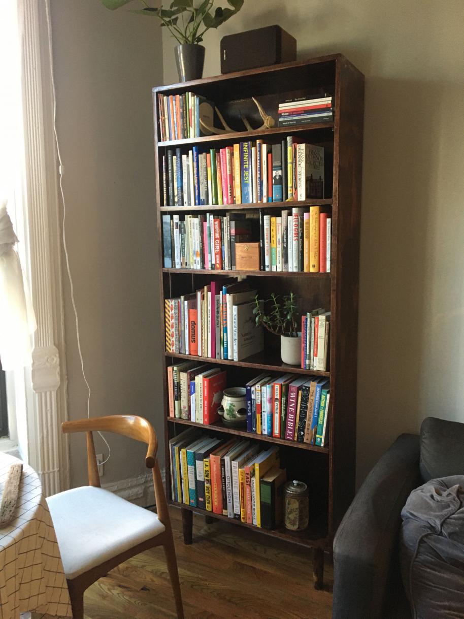

I just built this bookshelf in my tiny apartment in Brooklyn with a hand saw. It sucked.

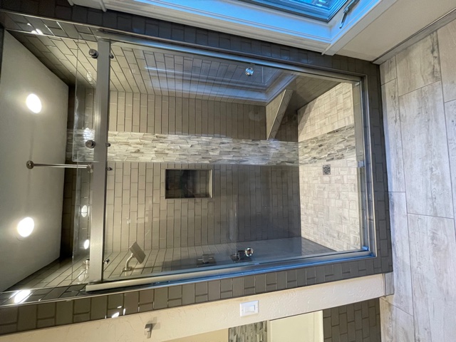

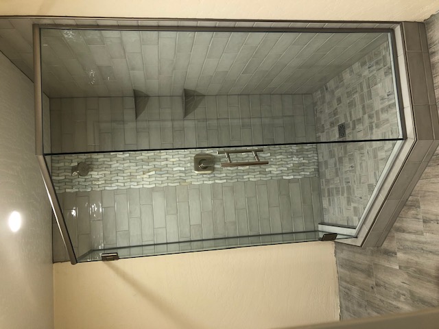

Man cave bath shower and master bath shower finished at Montana home.

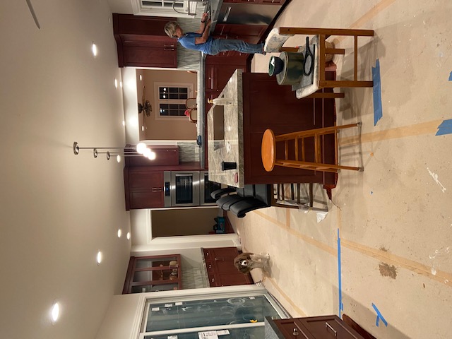

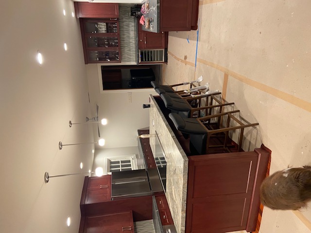

Kitchen remodel completed at Fullerton home:
