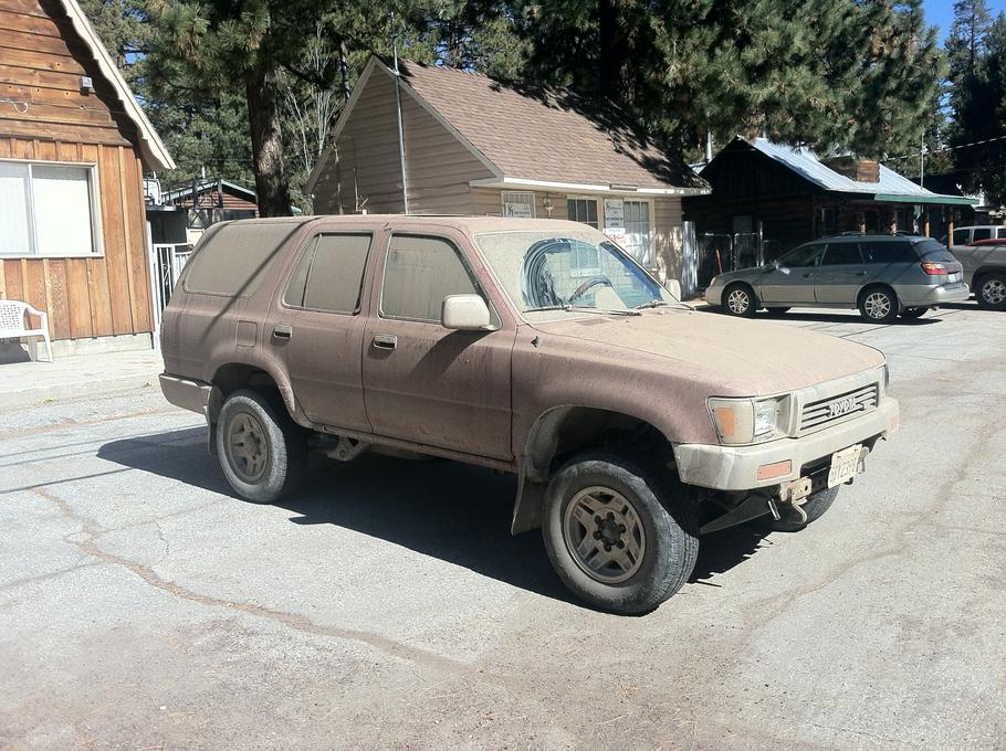

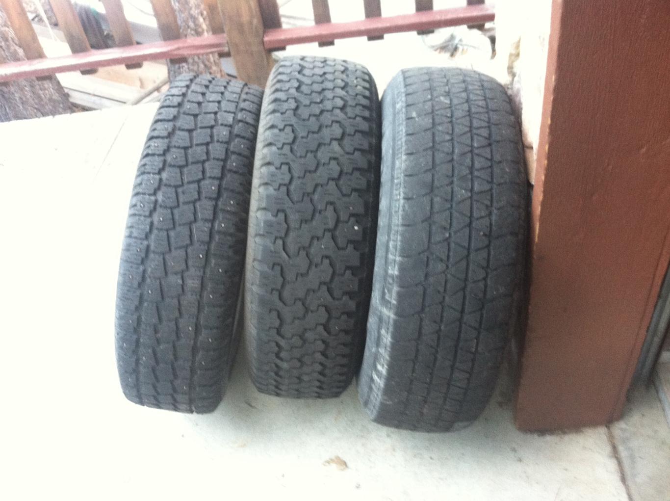

It is a 1990 Toyota 4Runner SR5 with the 3.0 V6 with the manual 5 speed transmission and 4WD. It has 235 tires on stock rims with stock suspension. The tires I currently have on there are El Dorado Golden Fury GFTs but those are almost done so I have a set of used Goodyear Wranglers for when those are gone. For the winter, I have 2 studded Hankook Zovac HPW401s which will help on ice/snow. The Hankook's are on their own separate rims so I can switch between them as often as I want so they should last me years.
(Hankook, Goodyear, and El Dorado respectively)

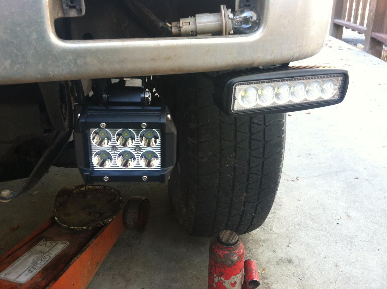

The square one on the left is a spot light and the rectangle one on the right is a flood light
Installation was pretty easy. Bought a wiring harness with a fuse, relay, and button. Ran the button through the firewall and put the fuse and relay by the fuse box. For mounting I just used the holes for the plastic valance that my 4Runner never had.

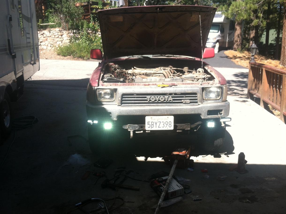

Pic of all 4 lights attached and my messy work station lol. For anyone wondering what's up with my turn signals, I took out the housings and painted them a metallic silver to make them brighter
