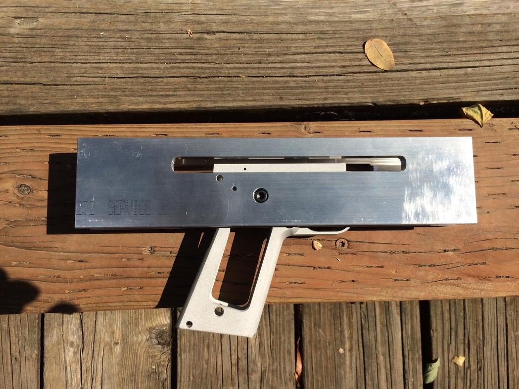

I wanted to learn about 1911 pistols and how they function, so I decided to build one from a Stealth Arms 80% kit. I received the kit about 6-7 weeks ago. The frame comes partially finished, but requires the builder to drill holes for the sear pin and hammer pin. I then used a jig and cutting car to cut the slide rails into the frame; did the same for the barrel seat.

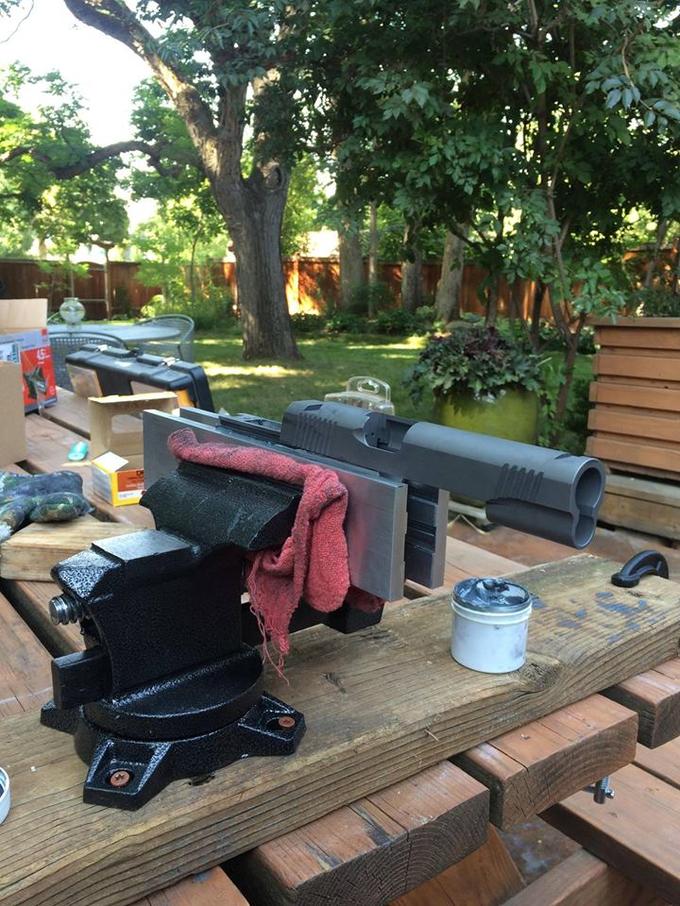

Next, I had to use lapping compound to mate the slide to the frame. This was time consuming and difficult at the start, but also fun. Ended up with a tight fit. Then, I assembled and disassembled the gun several times to make sure it passed all function testing...this required some fine tuning of the sear, disconnector, hammer, thumb safety and grip safety. After I felt confident it would function properly, I took it to the desert for some test firing.

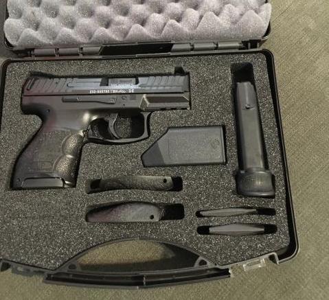

This is my "potato gun", the H&K VP9SK 9mm. Only bought it after I was at the wrong side of a revolver, and good thing my cousin had his (he didn't kill the "perp", the guy just dropped it and ran, and it was unloaded).
I also have a Benelli M2 field that I keep in the safe for hunting. As well, I'm probably going to get a higher caliber handgun or a rifle because 1, I moved to Montana and the wildlife is a tad scarier, and 2, I need more protection while over-landing.

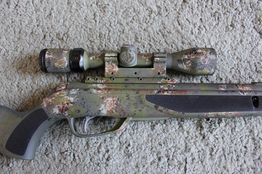

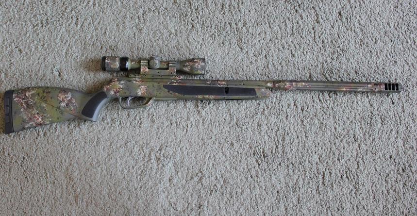

Hurt my shoulder a couple months ago. Decided a break barrel pellet gun would be good for rehab. Got a Gamo Hornet Maxxim IGT CAT in .22 flavor.
Decided it needed a paint job...rattle can and bunched up paper towels. :shrug:
Old Buckhorn scope and 300+ rounds and its starting to get fairly accurate...was all over the place when it was brand new...rather irritating...4-5 good then 1 flyer.
First pellet gun have owned that actually kicks...fun gun.
