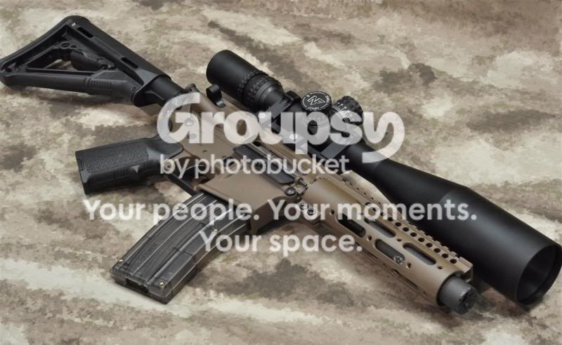

Got this back from my Smith! I had this dedicated .22lr upper Cerkoted and barrel cut to 4.5", shown with a SS Sparrow, OAL is 22". Loads of fun! The shop thought it'd be funny to take pics with a Night Force 5.5 x 22.
lmao - they were right... that is awesome!

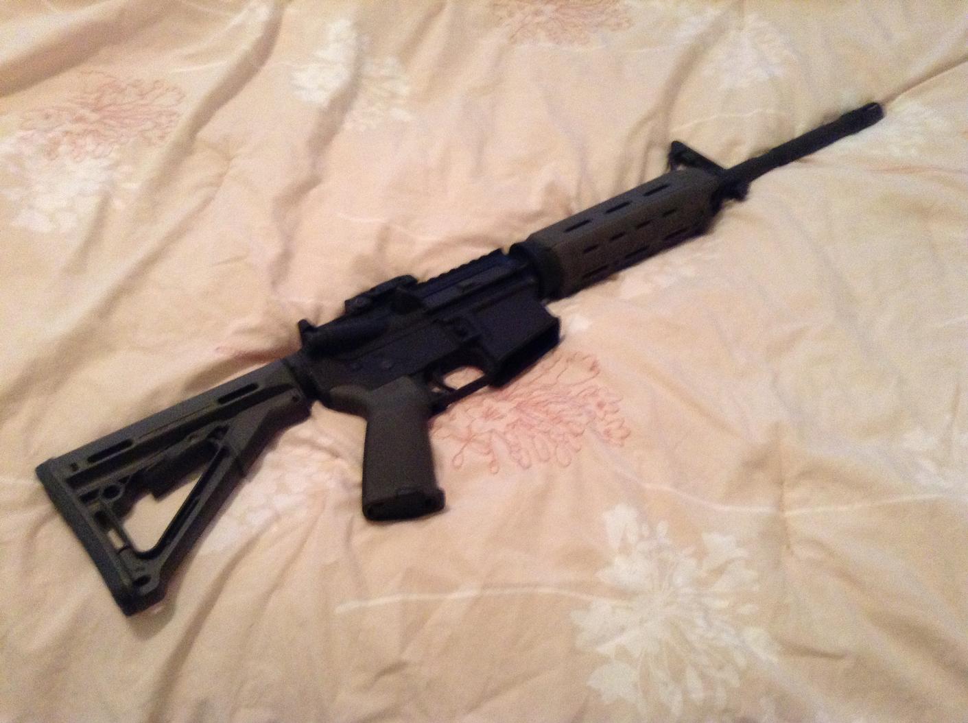

The new rifle.
Soon ill have my neighbor paint my xd9 and the ar to match.
