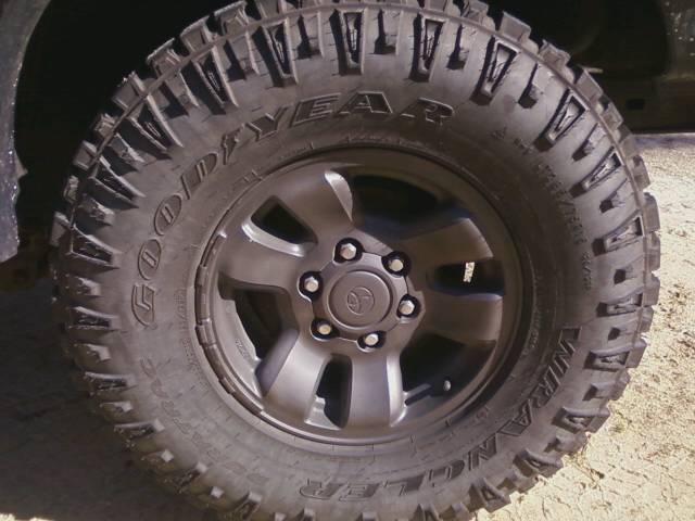

If you painted your wheels post up with color and a pic. It's hard to tell with the cell pics but the wheel on the bottom is slightly darker.
Rust-Oleum Metallic rattle can
244228 Metallic Charcoal (top pic)
Matched my rear license plate area on my 96 limited that you can barely see the 4runner decal. Did not match my fenders or body cladding

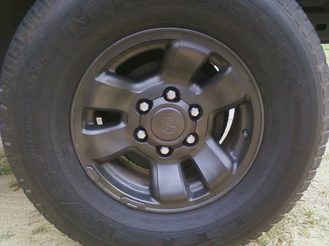

7250 Black Night Metallic (bottom pic)
Did a much better job matching my fenders and body cladding.
