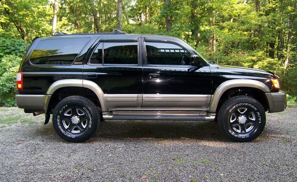

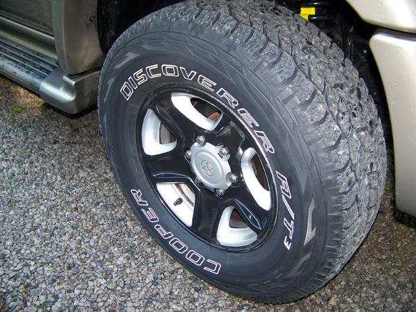

How did you do that two-tone? Just careful taping? That looks awesome.
Well with my baby boy crying, I didn't have time to tape. What I did was, sand the area that was getting paint. Then took some grease and did the area that wasn't getting painted. Wiped the rims down with acid tone and painted them. After they all dried, I wiped away the grease and cleaned the excess grease off with cleaner. Thanks a lot!

Did you take the wheels off to do each one? Is that silver or white inside? What grit sand paper? What paint? How many coats? Thinking about doing mine the same way. Do you have a zoomed in pic of a wheel?
Also, anybody know if it's ok to paint brake calipers? I would like them red.
Did you take the wheels off to do each one? Yes, done each one off the runner. Is that silver or white inside? stock wheel color. What grit sand paper?I used 220 because, that's all I had. What paint? used auto paint by rustoleum, got it at wal mart in the auto section How many coats? 2 coats. Thinking about doing mine the same way. Do you have a zoomed in pic of a wheel? No I don't.
Also, anybody know if it's ok to paint brake calipers?Yes, they make brake caliper paint, at any auto parts store. I would like them red.
Answered all you question above in red. I just went in not thinking too much about it and turned out ok. :thumb3:
