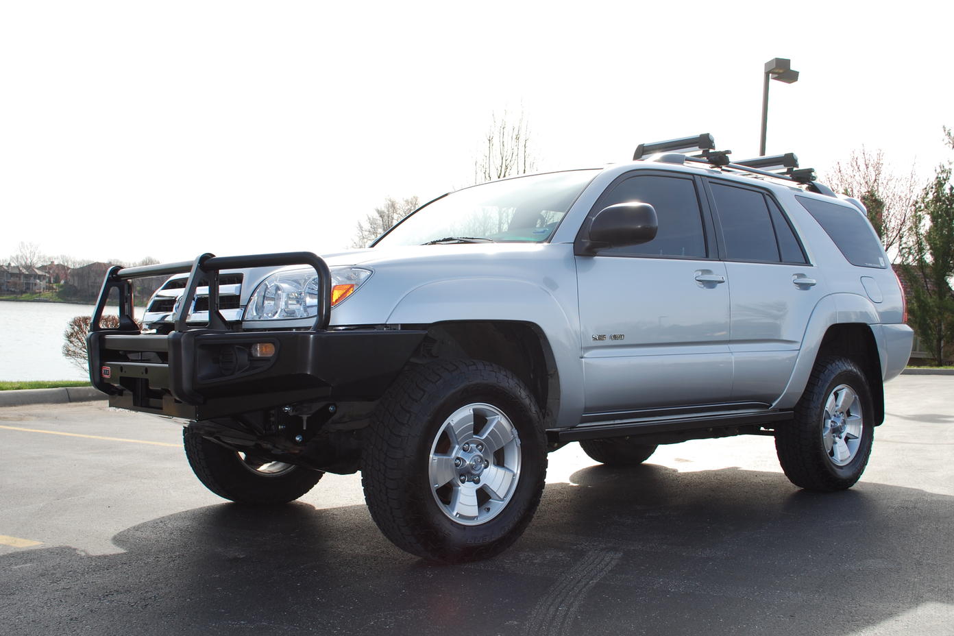

ARB and Shrockworks are some of the most popular bumpers. Shrockworks is probably the most popular or most liked. Downside is wait time in ordering, some people have stated 2 or more months. Ordered ARB about 2 weeks ago and have had it on for almost a week. Have been very happy with the it. Took about 4 hours.

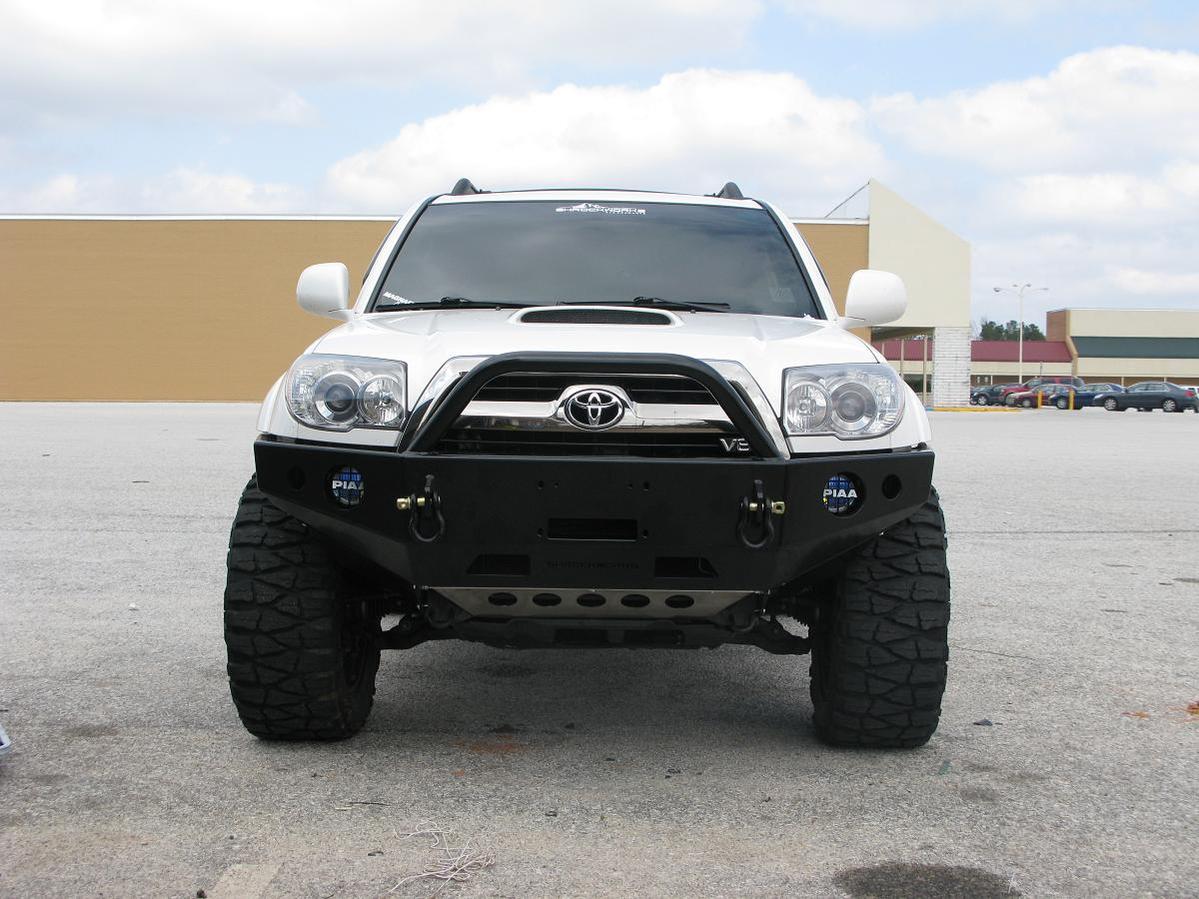

IMO the wait for shrockworks is worth it. They fit the contours of our trucks much better. Many people get the ARB for the instant gratification. This is how I looked at it... 6 months from now will you look back and wish you had waited a little longer?

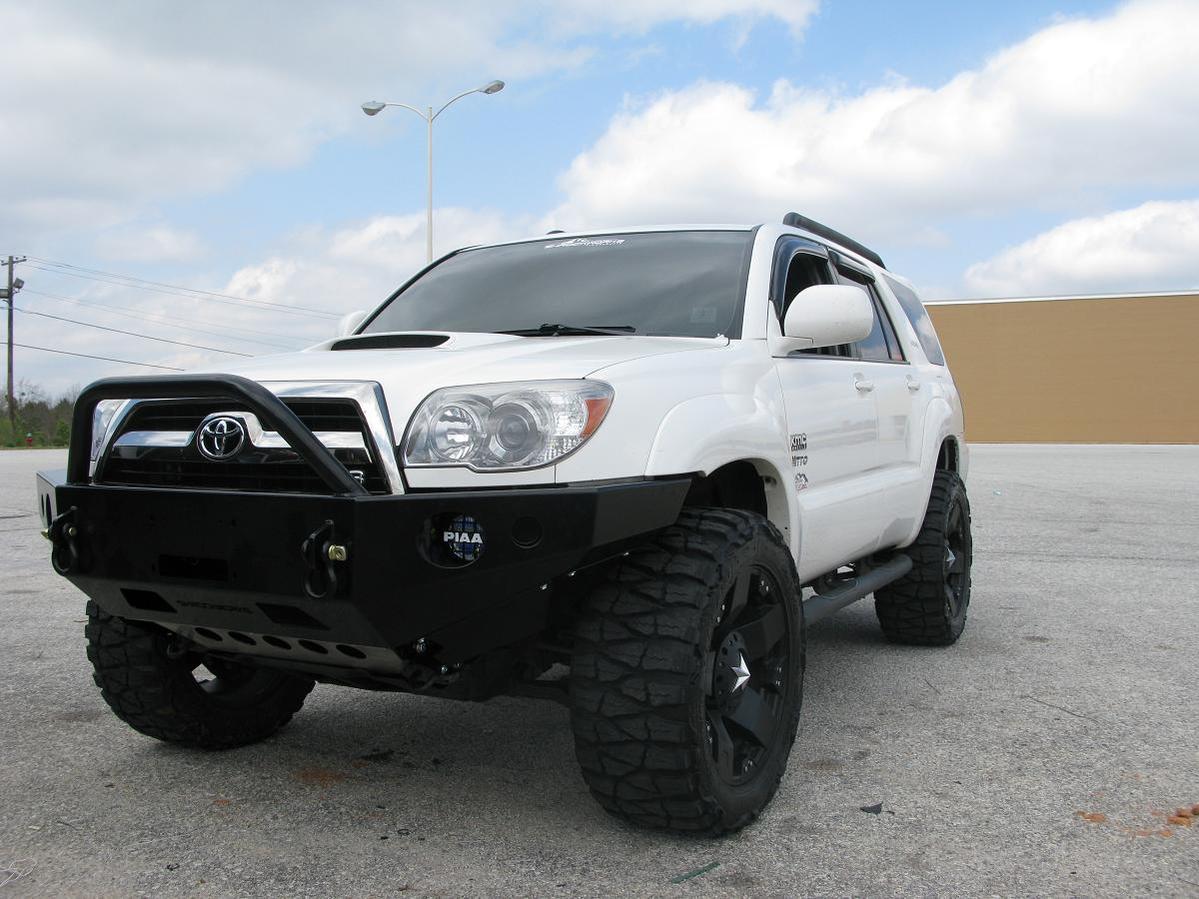

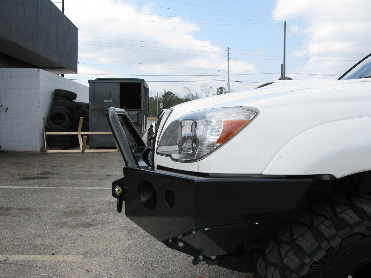

Do the bars on the Shrockworks stick further forward than the bumper itself? In other words, if you rin tinot a flat surface, what is the first point of impact?
It sort of looks likes the Shrockworks push inything (anyone) you hit down under the wheels than up over the hood. That would technically make it illegal (on the street) in many places.
As just a bumper I look the look of the ARB better, but mounted on the 4th Gen, maybe not...
Shock Works is more expensive and if I have to wait 6 mo for it, it is the same as waiting a year as 4wheeling is a summer thing here.
It's a tool as well as a jewel.
+ Shockworks = not airbag compatible

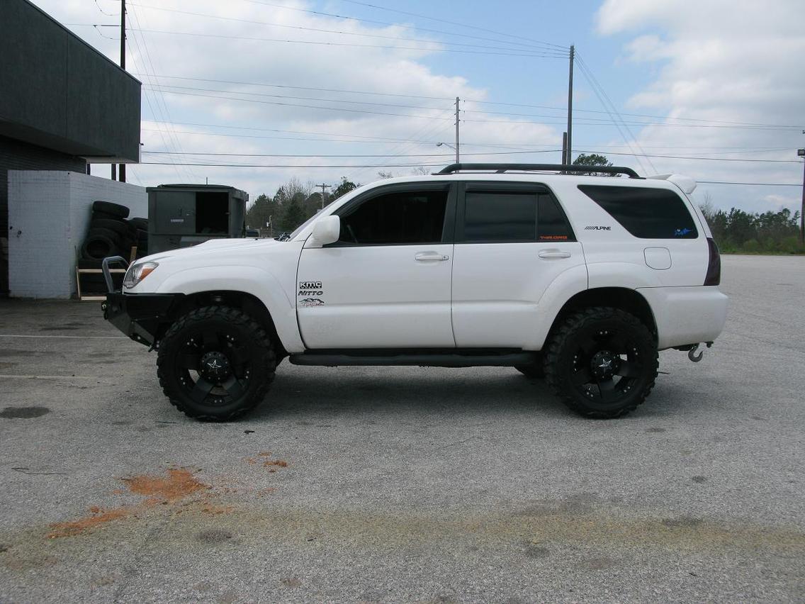

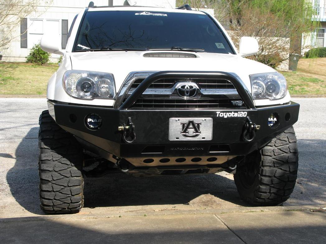

I am a little biased but I would say wait for the Shrockworks. My bumper was messed up for about 18 weeks while I waited for the Shrockwroks but I know it was worth the wait.

Autbond: How does the stock suspension handle the additional weight?
It is handling it ok as of now, I have started to notice it sagging a little. I have only had the bumper for about 2 weeks though. I am just waiting until I can get a full suspension and a body lift and do it all at the same time. The SW bumper weighs less than the ARB also, but if there is a winch being put in either one then the coils need to be replaced when the bumper goes on.
one thing you have to account for is, frame flex, when wheeling the frame will flex some, the bumers that sit tight will come in contact with body parts, most aftermarket bumpers dont take that into concideration, most custom bumpers will.
Let us know what you decide to go with :lookout:
Yes, very true. I was told by another guy on here to leave a gap, I left about a 3/8"-1/2" gap between the bumper and the fender; despite the way it may look like there isnt a gap. If you are ok with waiting, I waited 18 weeks, then you should go with the SW. The ARB sticks quite a bit more, just more bulky overall; not saying that it's a bad product. I have a set of PIAA 510's that were accidentally sent to me extra from SW and they sell them for $200 I will be happy to sell them for $150 + shipping if anyone here wants them.
