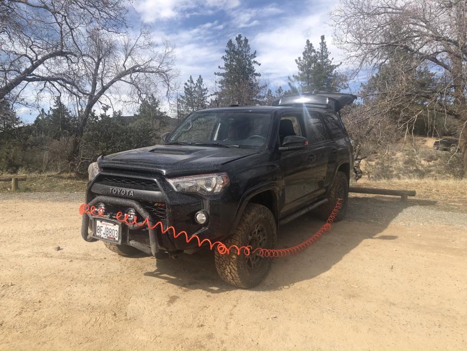

285/70-17 Wildpeak AT3W’s SL rating. 34 cold on road. 20 off-road.
