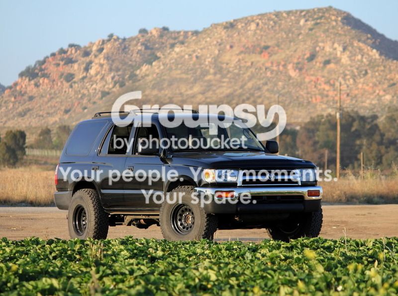

So I purchased a 98 4Runner 4cyl recently and have really enjoyed taking it offroad. I bought some 33's w/ rims off a buddy of mine and it does quite well so far. Due to the big tires im rubbing when turning the wheel so im wanting to upgrade the suspension now. Heres what suspension im looking at getting:
Complete OME suspension for 96-02 4Runner - Toytec Lifts: Toyota Lift Kits: FJ Cruiser Lift Kits, Tacoma Lift Kits, Tundra Lift Kits, 4 Runner Lift Kits, Sequoia Lift Kits, Toyota Truck Lift Kits
So my question is, am I wasting my time upgrading a 2wd to this extent? I don't plan on doing any rock crawling but I definatly want to go where others can't. Any info is greatly appreciated. Heres the ride:
