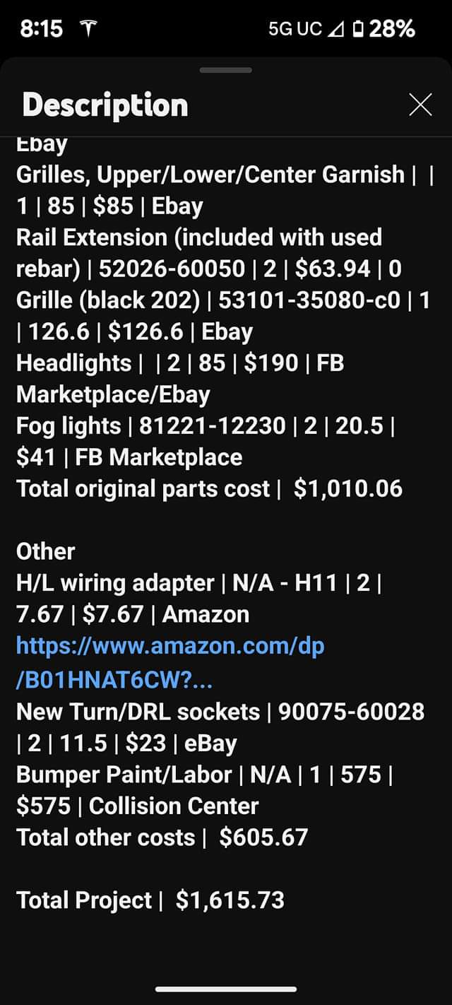

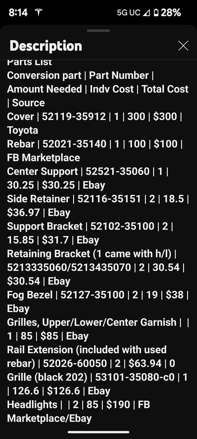

Here is a list of the parts needed to convert a 10-13 front bumper to a 14+. Credit to Underdog Motorsports.
Yikes - adding $1,700 and more than a little work to it before paying for a bumper may be more than I want to bite off. Hopefully one that fits will pop up somewhere within reasonable driving distance. Thanks!

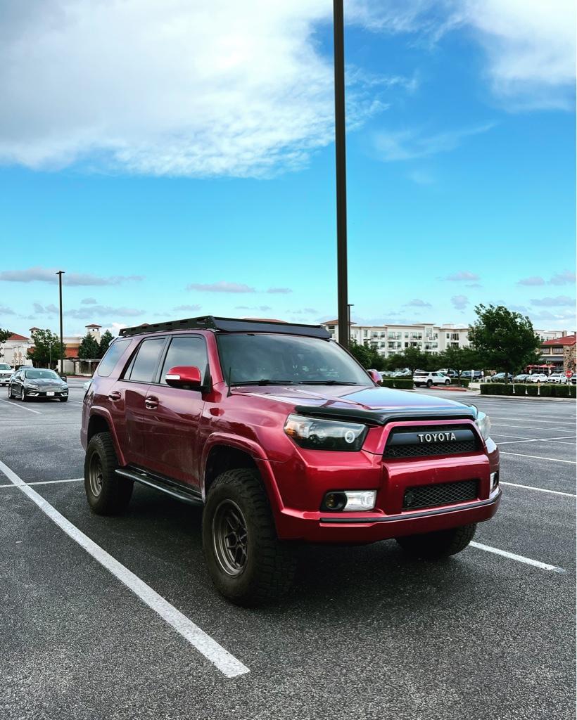

I have been just looking and slowly piecing it together. Finding used take offs has saved money. It is still pricey. I found an OEM bumper in my color so that helped a lot.
Haven’t posted on here in a while, so here it is. It’s come a long way but far from finished [emoji23]
