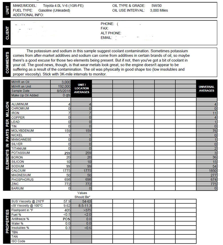

I've read many of the 4th Gen V6 head gasket threads, but wanted to start a new thread with my specifics. I've had my 2005 for a couple of months now and this is my first oil change.
I have no rough running symptoms or engine codes. No significant loss of coolant. No white smoke in the exhaust.
Despite that, my Blackstone analysis suggests coolant in the oil. Am I on borrowed time? What else should I do to diagnose this? Compression test?
Runs like a top with 192K, but the head gasket discussions have been freaking me out...now this. I'm on the verge of investing in significant suspension rehab/upgrade, but don't want to do that if a $3-4K repair bill is in my future.

It looks like it, yes.
For what it's worth, my last vehicle was a Jeep XJ and I was having overheating issues I couldn't figure out. So I sent an oil analysis in to those guys. They showed that I had coolant in the oil because they found Potassium and Sodium in there (at smaller levels than yours but only a few hundred miles on the sample). No other tests showed positive for a head gasket leak though (compression was good, it passed the combustion-gases-in-coolant test, no signs of coolant in oil or oil in coolant other than the oil analysis)
I took the head off and the head gasket was not blown but it looked like maybe combustion gases were escaping past it. I took the head to a machine shop and it was warped. I fixed everything, put it back together with a new head gasket, and it was perfect and I drove it in the middle of July for 10 straight hours. Later that trip I was going too fast up a very steep mountain pass for a 21-year-old vehicle and it overheated pretty badly. After that I couldn't drive faster thant 65mph without it running hot and risk overheating. When I finally got home, I took the head off expecting the new head gasket to be blown but it was perfect and the head was not warped. I put it back together again with a new head gasket but it still runs too hot on the highway. So I said "screw it!" and bought a 4Runner :)
So, I'm not sure that story will help - maybe it will illustrate how very difficult it is to diagnose a small head gasket leak. I think an oil analysis is the "pickiest" test you can do. Maybe it's too picky though and can cause a false positive. But there is a sign that there is something wrong with your head gasket and that warrants further investigation. If compression is good (test with the engine hot), it passes the combustion-gases-in-coolant test, you're not loosing coolant and/or it's not turning brown or getting milky looking.. then I would change the oil, drive a little more and send in a new sample. No additives, no weird oil. See if they still think you have a HG leak.
The good news is the rest of your oil analysis looks great! Maybe there is no contamination or at least you caught it before it could hurt the engine. In my case, the metals found in the oil sample where alarmingly high even for a 250k+ engine.
