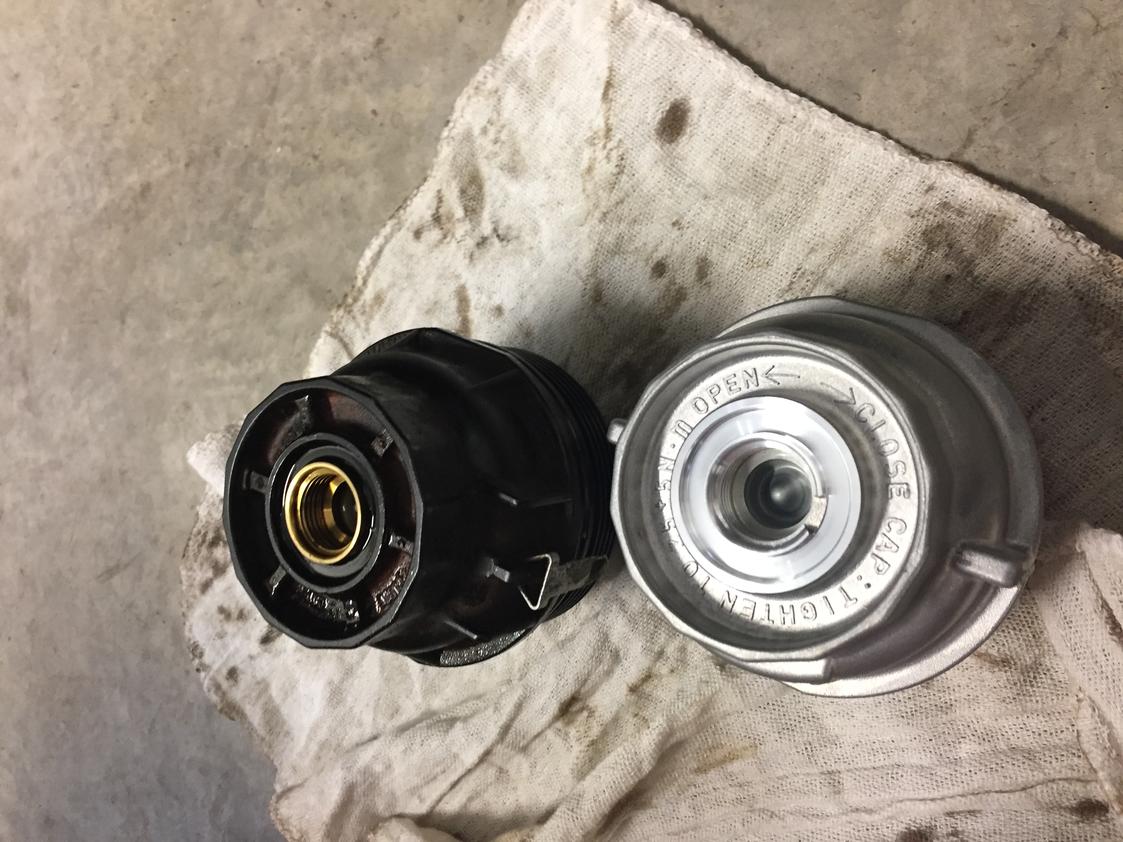

Yes it fits, Genuine Toyota 15620-31060 Oil Filter Cap Assembly, sorry no installed photos

Did you measure the center support post? I recall another member got a metal one and the center post was much shorter than the plastic unit used on the 4Runner.
Though to be honest, switching the posts over is easy enough.
Nice call, yes I did switch posts as they are not the same. Although I do not recall which was longer/shorter
