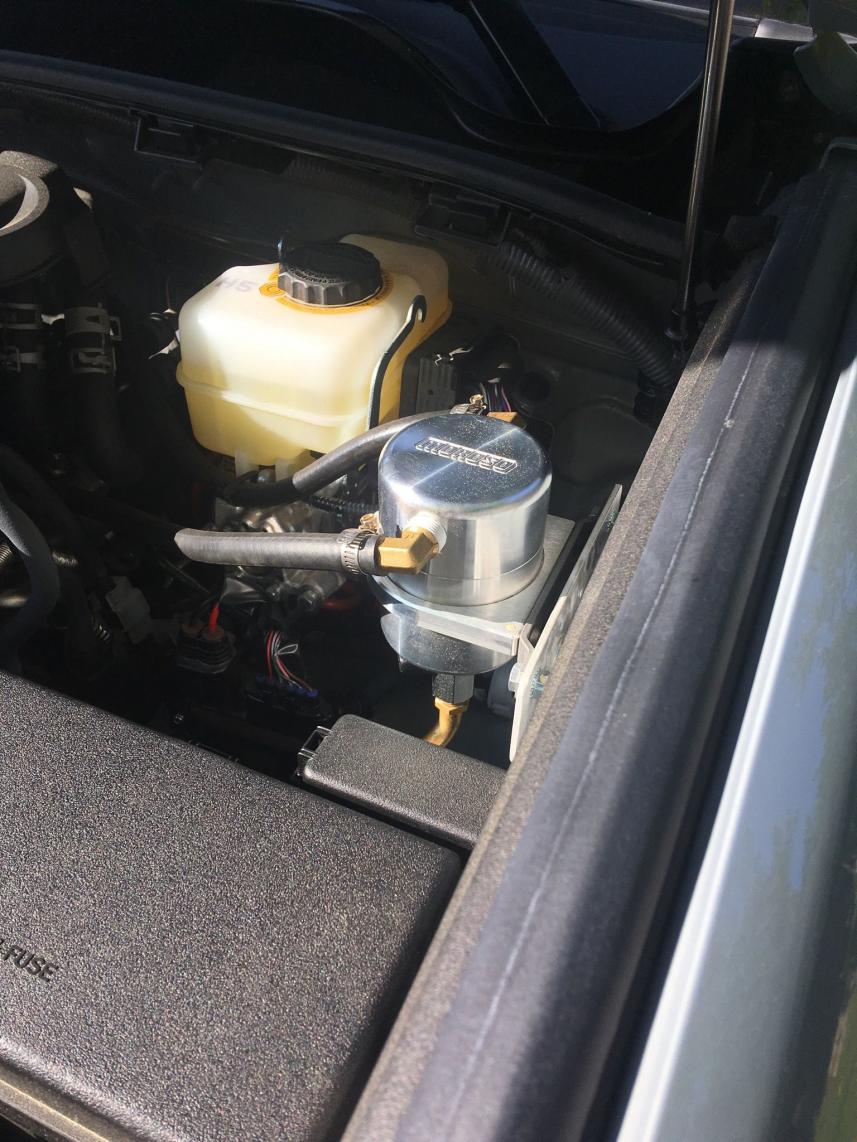

I am putting one of these in here once the weather warms up. There is a few places I could mount it. Where has everyone put there's at?
I mounted mine on the inside of the (drivers) front fender. There are a couple of factory, threaded holes, that can be used to mount a bracket. I had to fab a simple bracket to accommodate the can and hole location(s).

Thats where I was thinking as well. Found an old PC Desktop that will make a good bracket. By chance do you remember what size bolt you used ?

Got one from Amazon, ditched the crap hose it came with and running braided hose with AN fittings. Since I work in IT have access to old PC's, I'm using a pc cover to make my bracket from a template. Need to figure what size bolts fit in to the pre-factory tapped holes on the diver's side inside fender.
I mounted mine to the same spot as goat. Just printed a custom SLA bracket and has held up for a couple years now.
I believe the tap size is an M8x1.25, I can try to pull one later and confirm if I actually remember.
Was going to say M8x1.25, lots of this throughout the 4th gen.
