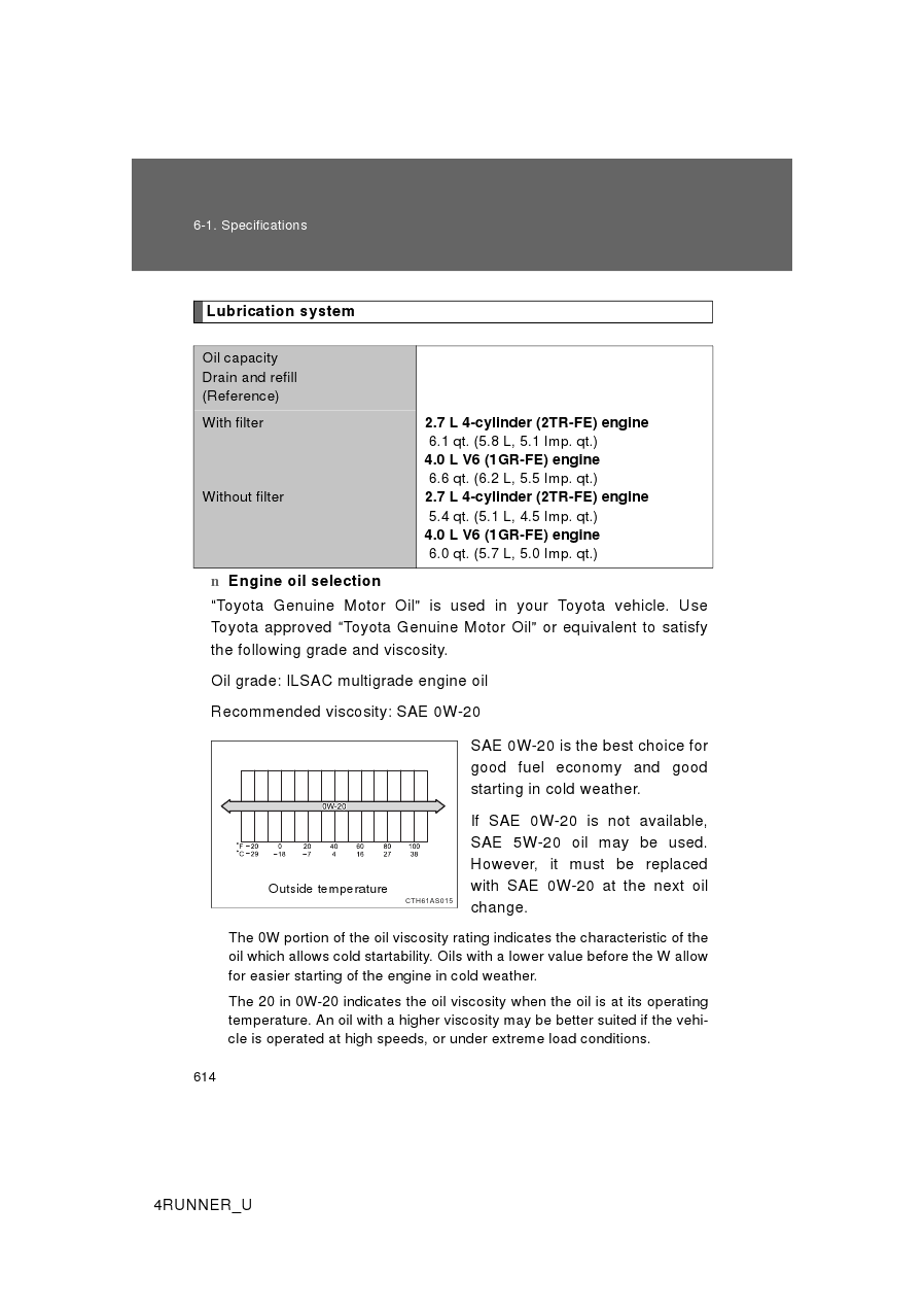

Also a doozy straight from the manual.Read the last sentence. High speeds? I don't see how they could ever deny the warranty because of using the wrong oil with a statement like that in the owners manual.
Just tell them your always late to work and have to travel at high speeds so you put in 50w........per the manual.lol

Not a Canuck, and not from the Canadian Manual, but the attached page from a large 2010 4Runner document has what you're looking for. I think you'll find that the USA oil spec is for CAFE appearances and nothing else.
