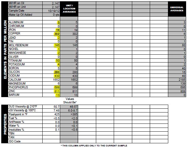

I did the same thing. I changed mine at 2100 miles and put Castrol Edge 0W-20. I have also attached the oil sample report from the "break-in" oil and of course the wear metals are high but at least I feel better knowing that the contaminates have been removed. I am sure you can run it 10k before your first oil change but I am old school and like to make sure that I do everything I can to prolong the engine. The copper and molybdenum are from parts seating and the silicon and sodium are traces left from the casting process. So We will see over time.
