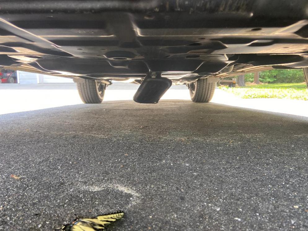

So I took it to the dealer for my lifetime free annual state inspection and got an oil change prior to leaving for the beach. Picked it up and drove 10 miles back home.
One bolt was gone and the other one fell off when I touched it. The service writer and the service manager were like, "Jeez, just when you think you've seen it all."
