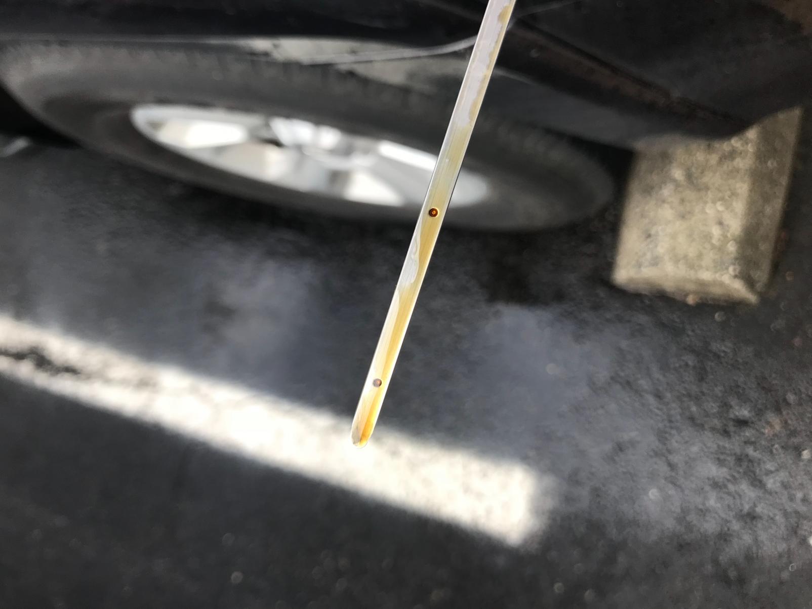

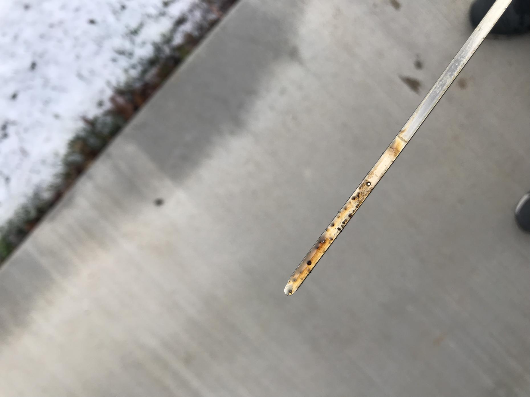

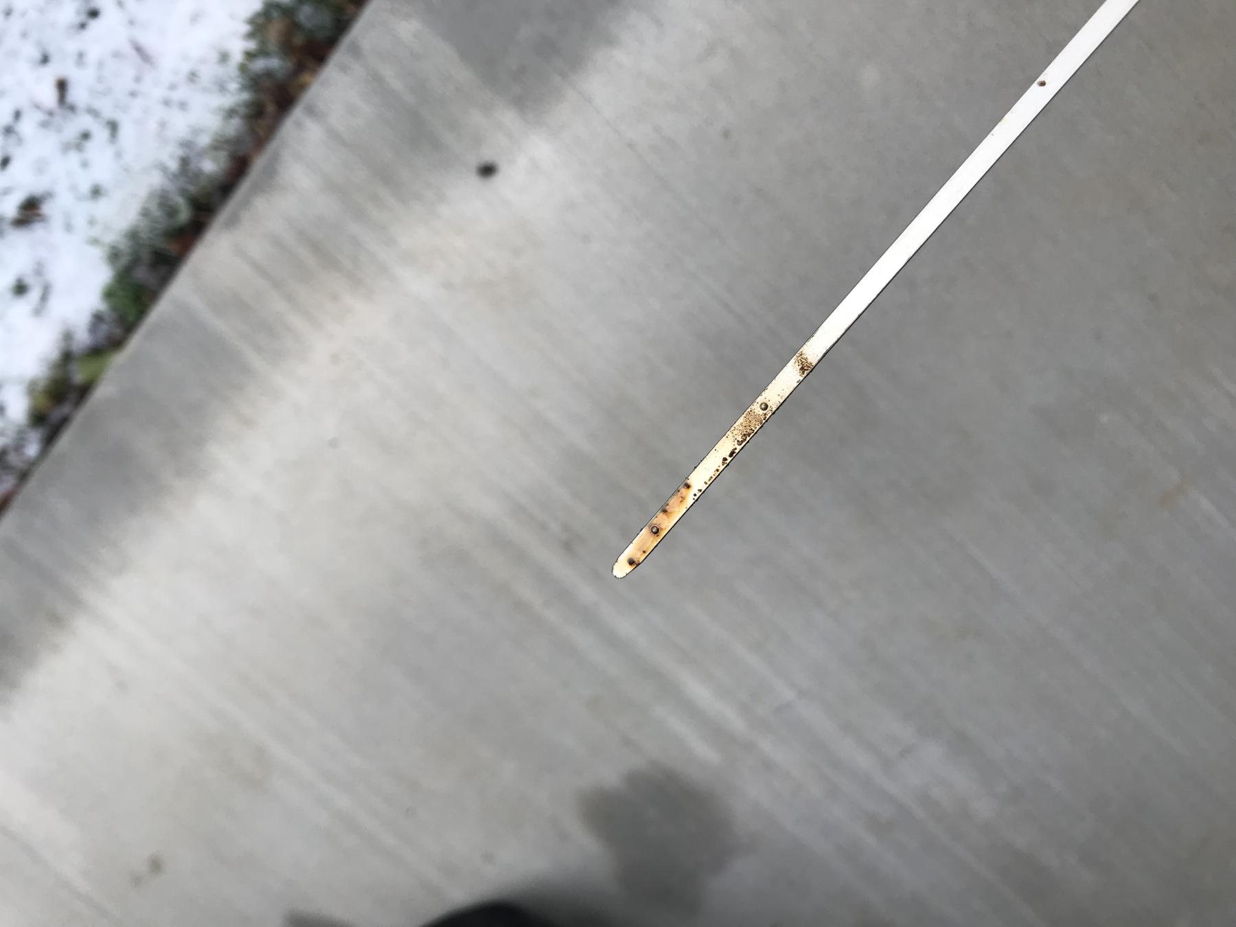

I recently changed the oil of my 2016 SR5. The previous oil change was at the dealership. I drove 7000 miles after that. I checked the oil dipstick and the oil looks pretty dirty. Wonder if the 10k OCI is really good for the engine. I checked my Tacoma and it’s similar. I know it has been debated again and again. But from the dipstick I would go with shorter interval since I’m doing oil change myself now I saved enough labor cost. Although saving the environment is another question. What’s your experience and opinion?

My 1998 with 230k looked cleaner than that on an 8000 mile interval. I would actually question whether they used synthetic. Conventional doesn't cause sludge, but it cannot attain a 10,000 mile interval. I would even argue that 10,000 is pushing it regardless of oil type depending on driving conditions. Those black bits look like sludge. Stick with your Mobil 1 at 7000 mile intervals for now. Once you stop seeing such sludge on the dipstick, you can decide whether you'd like to push the interval back to 10k. Simple enough? Not the worst issue IMO.
Make sure the air filter is new, fresh synthetic oil is used and a new oil filter is used then keep an eye on it.

I just checked mine at 5K and the oil on the dipstick looked more like your second picture albeit with a slightly darker color. I change the oil every 10K using the Toyota 0W20. If I suspect that my dealer was using anything other than 0W20 full synthetic, I would specifically ask them to use the proper oil. I would also be changing oil no longer than every 5K miles.

generally speaking, eyeballing the dipstick is not a credible way of judging the condition of the oil. that said, your first two pictures are worrisome and look... not good.
probably too late now, but i would've submitted a sample of that dealer oil for a used oil analysis. in any event, you'll undoubtedly be better off changing your own oil from this point forward.

You're being swindled. Synthetic blend tends to be majority conventional. It cannot handle 10k. At 5k I'm sure it's fine. I don't think your 4Runner is permanently damaged, but you need to get on this now that you caught it.

That sediment or what have you on the dipstick is alarming. I've never seen that. Hopefully it's just foamy oil from a recent drive but it's worth mentioning to the dealer if under warranty.
