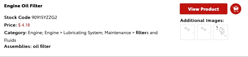

Since the supply chain issues, Toyota has changed back to the Made In USA oil filters, but the price remains cheap at $4.18 at a local online parts dept.
