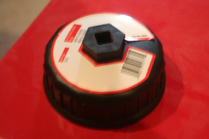

As a follow-up....
.....I found a cap wrench at Advance Auto Parts. It's a perfect fit for the factory filter that's on the V8.
The brand is Ampro, 73mm, 14 flutes, 3/8" drive.......$5.49.
BTW....the factory SST tool is about 60-70 bucks......ouch!
