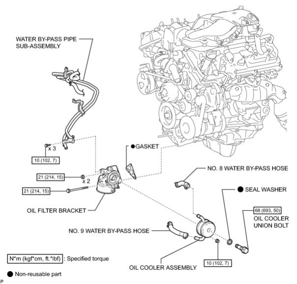

Anyone know the torque specs for the 3 bolts that hold Oil Filter Housing (Filter Housing - Toyota (15671-31040)? This is for a 2016.

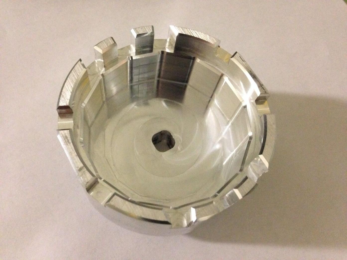

Sorry don't know the torque specs but want to answer the other question.
I like this one. Used the 4th gen tool for a couple years. Now in the 5th gen I got this one from the same guy on ebay.
Oil-filter wrench Toyota/Lexus/Scion - 09228-06501 | eBay
I'll use the 5th gen oil wrench this weekend on the plastic canister to remove and the aluminum to install. I'll remember to add a comment here confirming it works. But I bet it will.
