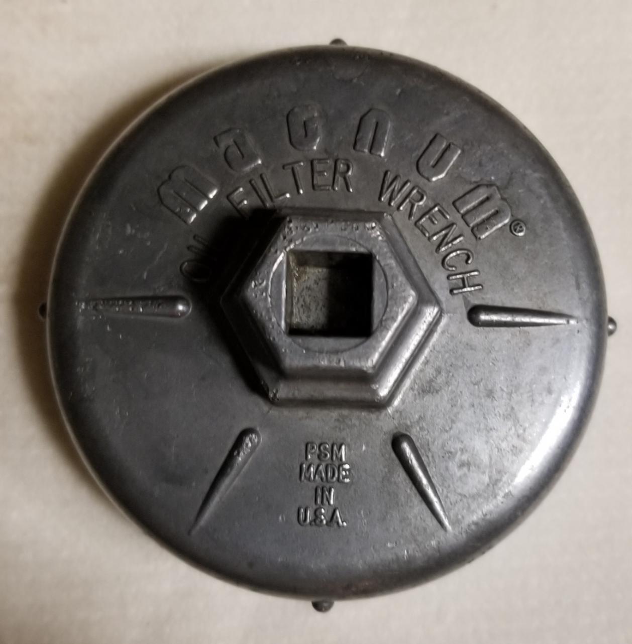

I've gone to a few auto parts stores as well as Walmart and Ace Hardware, but none has the correct size for the OEM oil filter wrench our trucks use. I'm not looking for the band, strap, or universal type wrench and I'm not willing to pay the dealer their outrageous price for that wrench. The type I'm searching for is the one pictured here. Mine is a V6, not sure if V8 uses the same. If you have any leads that would be awesome. Thanks.

The one I have used successfully on my V6 is labeled 73mm with 14 flutes and 3/8" drive. Its a Capri tool that also fits a 996 T 3.6, so I think its maintained the dimensions. Id check Amazon lol

I use this one, no issues!
uxcell A16041800ux1249 14 Flutes 73mm Inside Dia Cap Type Car Oil Filter Wrench Cup for Lexus Amazon.com: uxcell A16041800ux1249 14 Flutes 73mm Inside Dia Cap Type Car Oil Filter Wrench Cup for Lexus: Automotive
Edit: forgot to specify, this fits the YZZD3 Toyota filters perfect. Not an issue for me as I always use Toyota filters.
There is no specific / universal filter wrench for “your” vehicle. Every filter brand is unique in size. Bring your new or favorite filter to advance auto parts and choose the wrench that fits it. They come in various sizes. One will fit and the cost $5-&10. Dont over complicate it.
If you switch filter brands, your wrench may no longer fit. I’m partial to Purolator filters

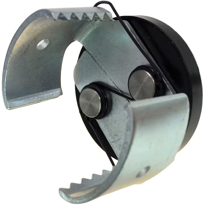

This style works similarly except it uses teeth to grip onto the filter. Hands down the best one I've used.
I like the look of that...where'd you find it. Haven't seen that style before.
