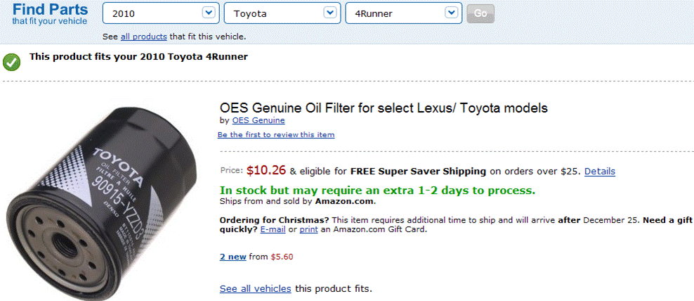

Regular filter
This is probably just a mistake by Amazon (See image below)...
It sounds like everyone just changes the element now, but can you actually change the entire filter canister (Like older generations did), or is it really just the element and this is a mistake?
I just changed the oil a few weeks ago and yes, you just change the element. Besides, the OEM oil filter element only costs around $6 at the dealer.
