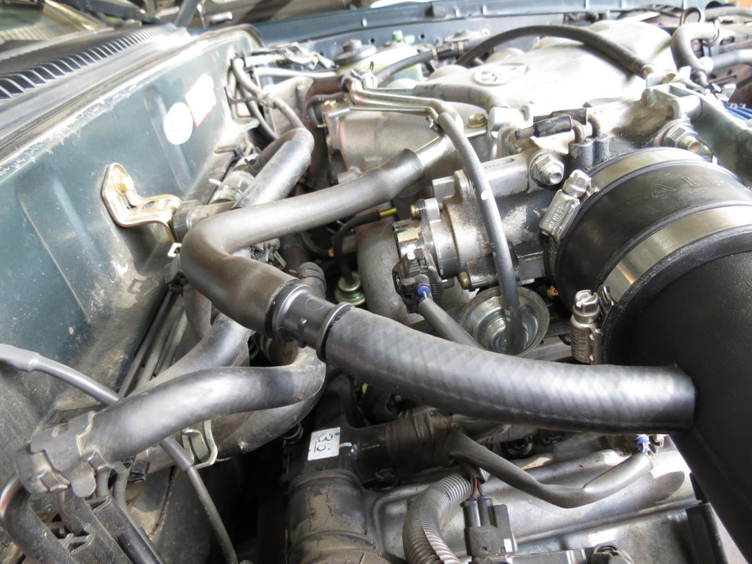

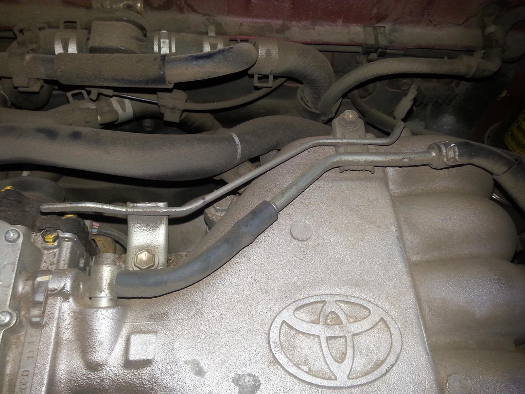

I did the ISR mod a few weeks ago and noticed some oil in the TB, looks like its coming from the vacuum hose in the picture. I cleaned it up and researched a bit and thought maybe it was the PCV but this hose leads to the rear of the moter. Just last night I replaced the ISR with a Airaid and there was a little oil in there again. I know its not the K&N because I found the oil before I put that in. Here are some pictures. Anyone know whats goin on?

does that one go to the other side of the valve cover? emissions? vally pan area under the intake? not exactly sure where that line goes with out getting off my butt and going to take a look.
you will get some oil residue on the inside of your throttle body from your PCV valve on the passenger side valve cover. up front.
It connects to the intake hose just before the TB. When I take it off there is a small amount oil. My truck never smokes which I have read about. If you follow the hose it goes to the back, by the firewall, of the valve cover on the right side (drivers side). It does not connect to the PCV valve. I briefly looked at my PCV Valve and it looks new.
Are you talking about the breather hose. If you are, It is quite normal to have some oil residue.
If it is really bad, then you have excessive blow by on your piston rings (worn engine)
It doesn't seem bad, but of course I don't have anything to compare it to. I guess I will ask the dealership when I bring it in for the next oil change.
See if you have any blue or white smoke from the tailpipe on first start-up in the morning.
If you want to really get to the crux of the problem, perform both a dry and wet compression test. My .02 is bad valve guides, but YMMV.
As said, some oil is normal.
Another possible cause of excessive oil could be a bad PCV valve (positive crankcase ventilation). The tube in question should be the air into the crankcase and the PCV valve should be the suction out of the crankcase.

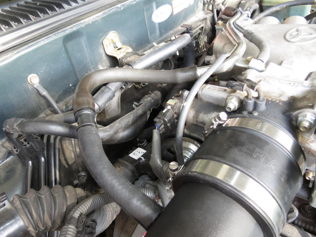

Throttle opener
In the op's pics it looks like that vacuum hose is connected to the throttle opener, see this diagram: http://www.mr2.com/files/mr2/techinfo/Random FSM Data/3vzVS5vz.pdf
Not sure that helps but I've been trying to figure out why mine doesn't have that connected yet purrs like a kitten at idle and roars like a lion down the road. I've heard it was only used on pre-2000 units? Pic below is from an '01.

On the 01/02, they have a catch filter to reduce this oil. The filter is shown on the left/top of your picture. The line should still connect to the intake tube.
Thanks for the prompt response Gerdo. I'll take another look at that afterwork today. That's been bothering me for a while...
In the OP's first picture, the larger brownish hose (he attached another hose to reach the new connection). This hose usually connects to the side of the rubber elbow before the throttle body.
From what I read and keeping an eye on mine it seems to be normal. I was really worried after reading about the oil blow by in the pistons but I never have any white smoke at all from the exhaust. Just to be safe I replaced the PCV valve with one from the dealership.
