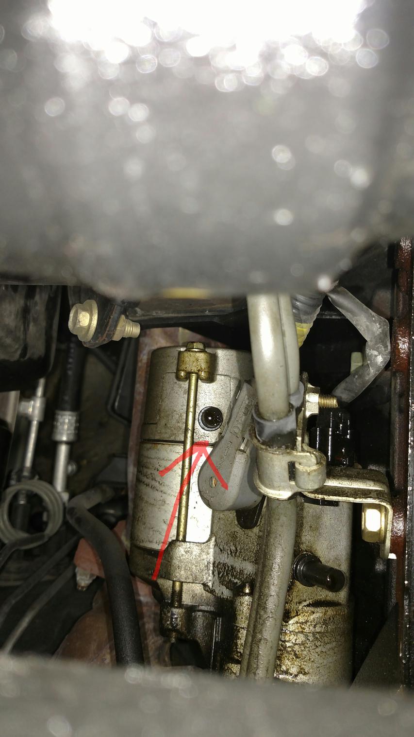

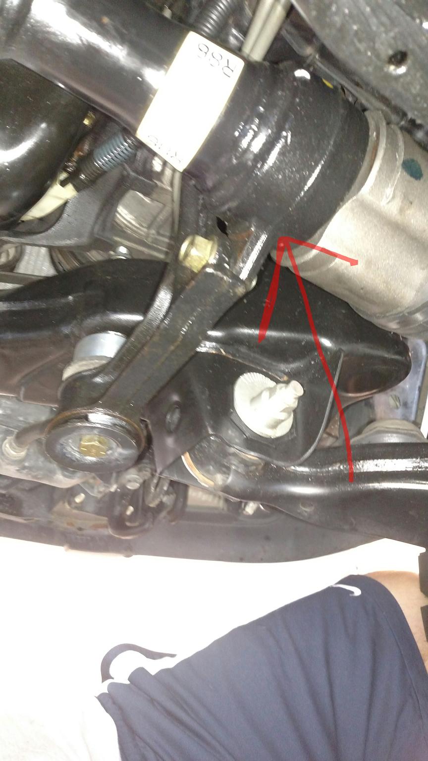

Get it home and its still leaking, however not nearly as bad. The oil is dripping off the axle where it bolts up to the front diff (I'm not sure proper name for this). I've tried to trace the leak up but don't see much oil at all. Take a look at this location and see if you have any input. Thanks in advance.

First thing is that the starter in the second picture does not leak oil. Probably is residual from the VC gaskets. Wipe it down and you should be good to go. If you then still see oil you might look over his work.
The leak in the first pic is from the front diff where the CV mates with it. When the CV is changed and one is not careful the seal can tear. It isn't too hard to change out.

When you replace a CV there's a seal inside the differential. It is suppose to be flush with the outside housing of the differential. It's easy to accidentally push the seal in to deep while installing new CV, because it has no grove to stop it from going in to deep. Which could cause little bit of gear oil loss. So it could be gear oil leaking from the front differential. Wipe that CV and front diff clean and drive it around and check. If the seal isn't sealing properly, you will see gesr oil between front diff housing and CV. In this case, you need to remove the CV axle, inspect the seal or replace the seal with new. Brand new seal is about $20-$30. How do I know ? Because it happened to me. If you replace the seal, if that's the problem. Then when installing the new seal you should install it flush with the outside of the front diff. You can use a large socket to push it in evenly. Be careful, take your time because its easy to demage the seal. The seal is also OEM only.

Not yet, haven't had a chance. I bought the driveshaft oil seal the other day but I'm not sure if that is the fix or not? Does that seal go where I have my arrow pointed or where the far end bolts up in the center of the vehicle?

It goes where you have the arrow pointed. You simply remove the CV axle, and the seal is right there !! It has to be flush with front differential outter housing. The part that almost touches the CV. You pull out the oil seal, and carefully install the new one. I'd use a big socket, same size as the seal to even push it in. Just don't push it to far. Like I said, there's not grove or anything to stop the seal from being pushed in to far.

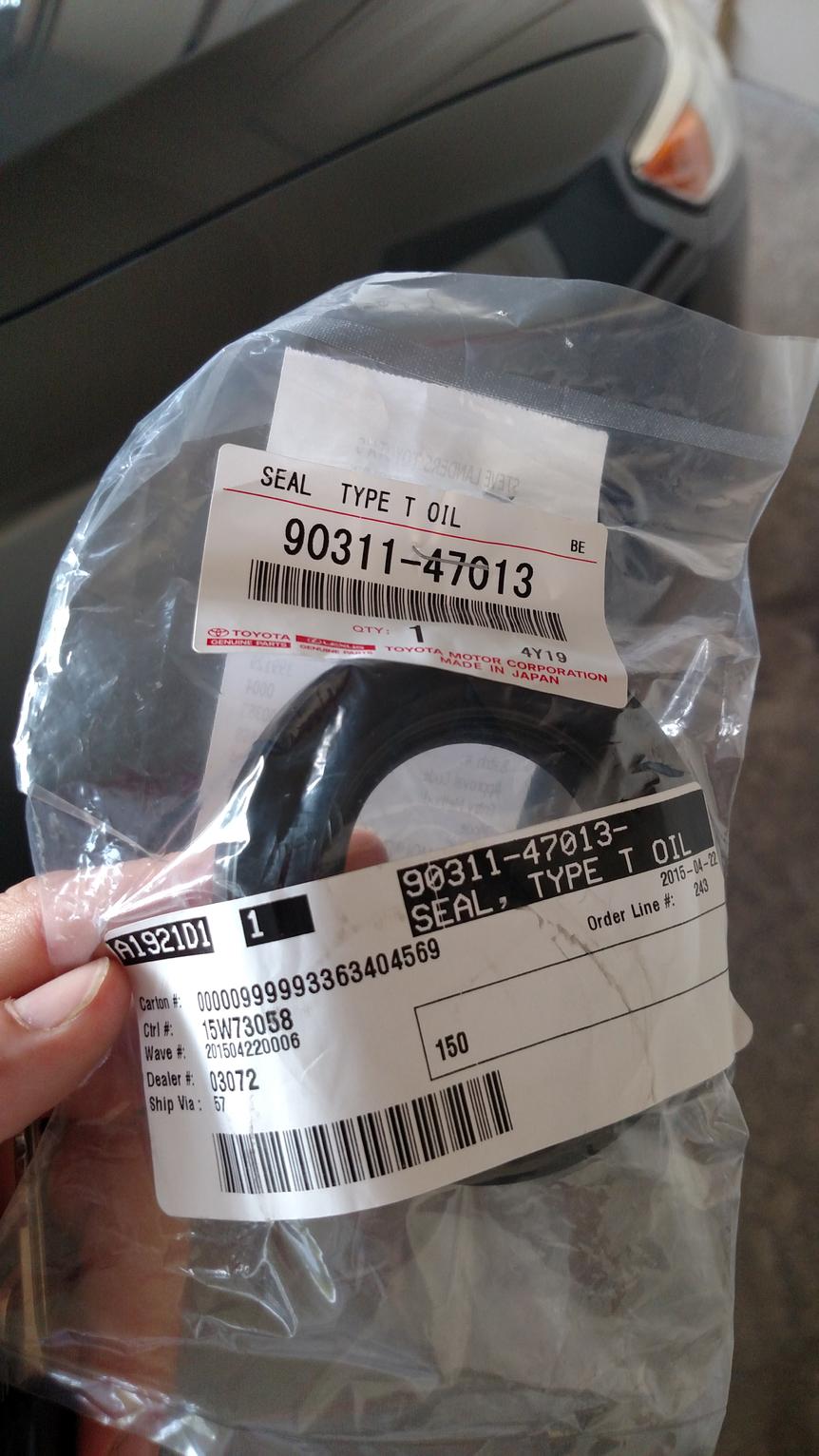

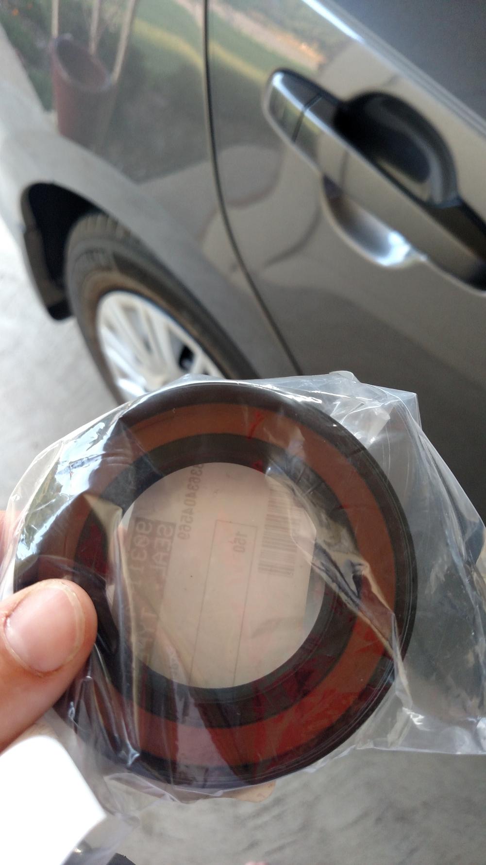

Sweet man. Really appreciate it. This look like the correct seal if you can remember? I got the part # off here bit when the dealership ran my vin it was wrong.

So... Brand new passanger side axle, brand new seal. Brand new driver side axle, new oil seal.
