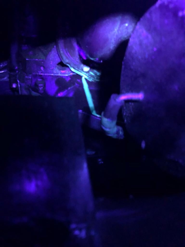

We’re in the same boat. Did the valve covers and oil cooler but still have a small leak. Used UV dye and thought for sure it was the back of the oil pan.
Dropped diff, resealed the pan with Toyota fipg and nope, still leaking, just less than before. 99% it’s the RMS. Only getting 5-6 drops overnight.
