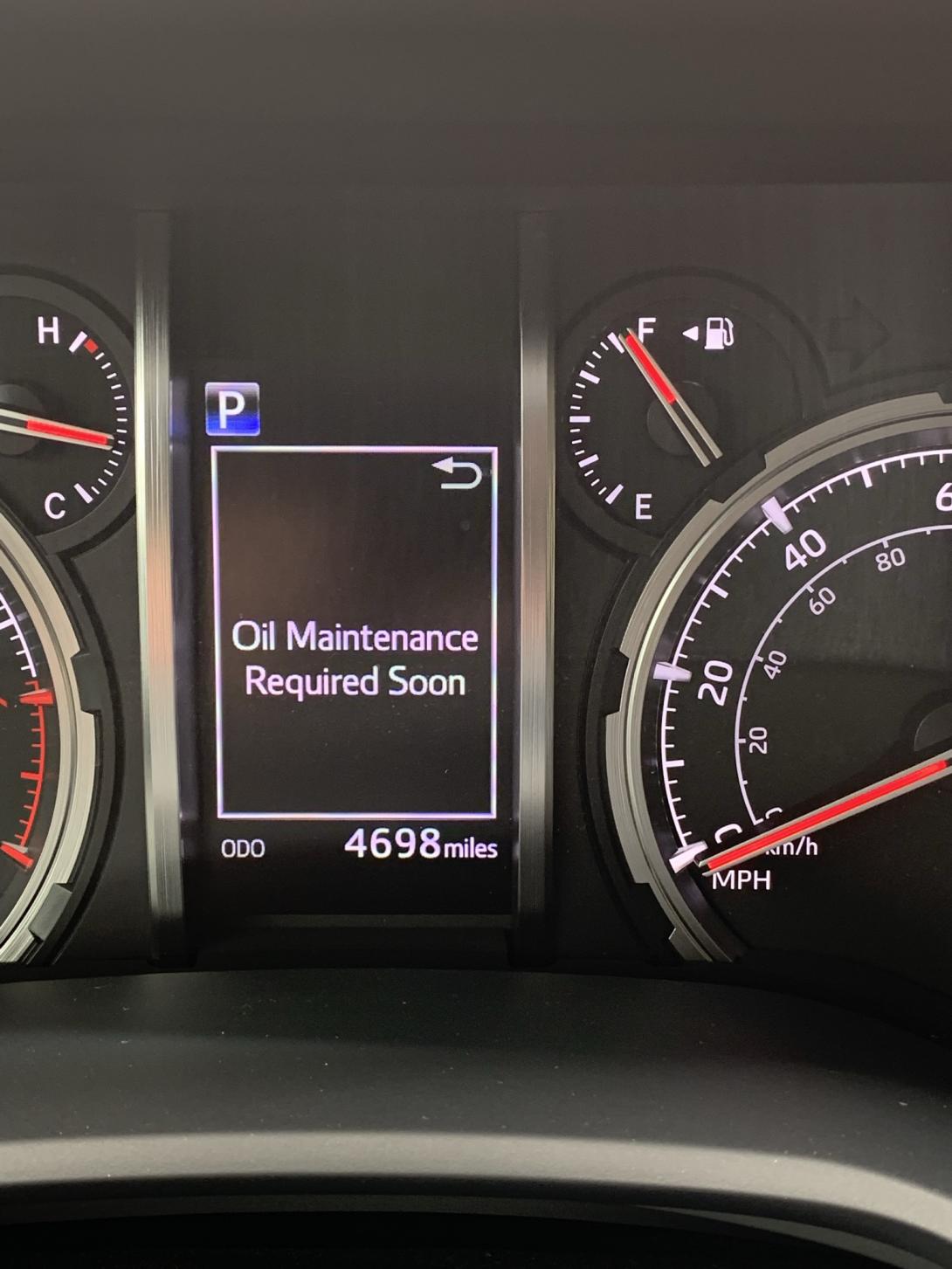

Did it really say "oil maintenance required" or just "maintenance required." I've never seen "oil maintenance required."
Mine literally said that
Says "Oil Maintenance Required" on the screen between the speedo and tach.
You have to press the back button the see the other screens.
