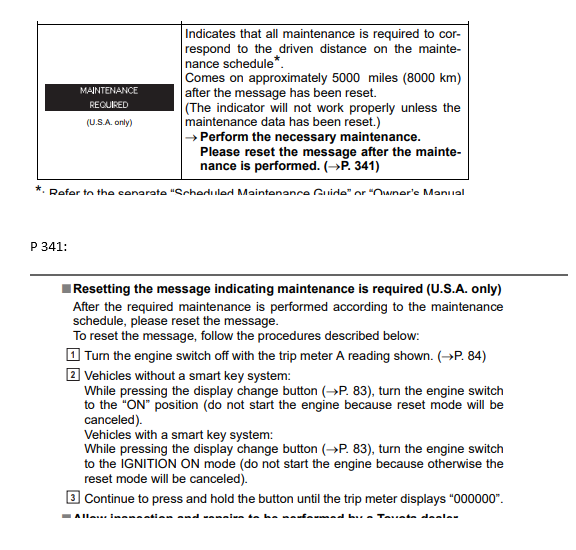

Did you do what a 2016 manual tells you to do? This is not the H/U.

The light comes on every 5000 miles because that's the maintenance interval. Maintenance isn't only engine oil changes. You can see all the maintenance and inspections listed out in the owner's manual. Early on in the vehicle life, it is a lot of inspections, tire rotations, etc. As the mileage gets up there, it gets more intense for drivetrain fluid changes. BTW, the oil change interval is 10k miles for normal driving; 5k miles is for severe service. The criteria for severe service is also in the owner's manual.
Agreed. 5k. My 2012 and my 2016 agreed as well. It doesn't measure oil life or anything based on usage. It's just a 5k timer.

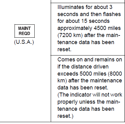

I think it behaves the same as my FJ Cruiser did - its owners manual was a bit more explicit - the Maint. reqd light would start coming on at 4.5K miles since last reset -
From my FJC manual:
