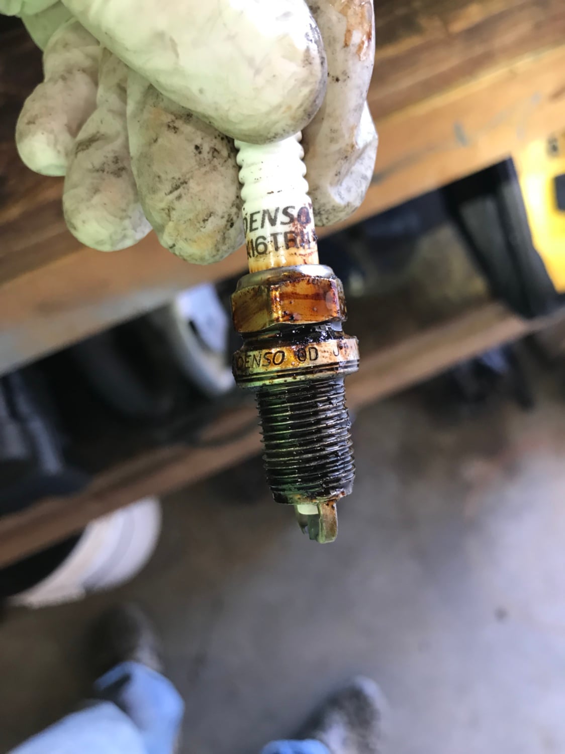

Oil on spark plugs.
Ron Burgandy
What would cause this? valve cover gaskets?
There are round gaskets on the spark plug tubes in the valve cover. When they fail, you can get oil accumulating around the base and up the neck of the spark plug. They typically come with replacement valve cover gaskets, 3 per side.
Buckaroo
Spark plug grommet/gaskets. They, just like the valve cover, will crack and leak all over the place.
Good news is your spark plugs will be easy to remove lol.
Word to the wise. Go OEM.
My Fail-Pro spark plug tube seals lasted 1 year before leaking, then I bought OEM anyway. Waste of time and money.
Exactly above^^^. I used an aftermarket valve cover gaskets, and after driving 3000 or so miles it started leaking. Tighten the bolts yet it leaked. Then went with OEM. Aftermarket DOES NOT go with a TOYOTA.
