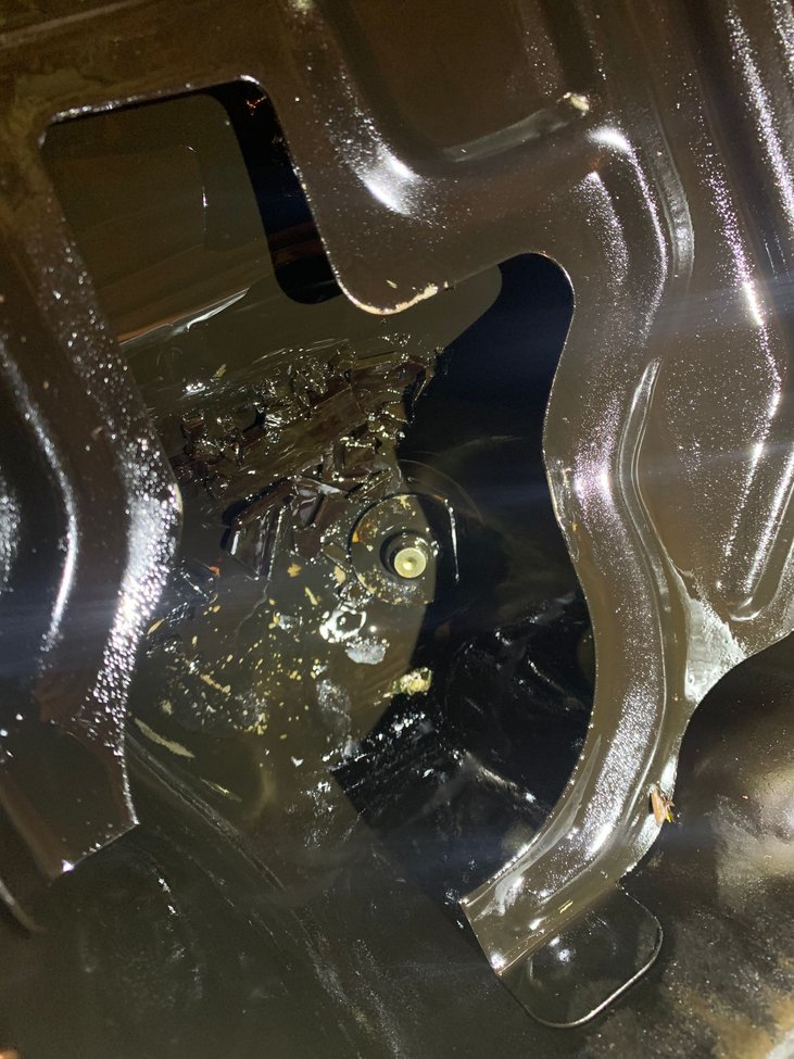

other not so good news. I think I found the timing chain guide from the original. It’s in pieces in oil pan I’m about 90% sure the one in the motor is still there but now have to pull valve cover and double check. Yay i wanted to adjust valves anyway hahaha.

Hopefully this is the original timing chain guide that disintegrated and caused the previous owner to have the chain and guide replaced.
https://cimg8.ibsrv.net/gimg/www.yo...880fce7e64c69c30500702b2b8c10c3462c919be.jpeg
It has 22R printed on it and is dark brown so thinking it might be stock original.
If I remember right the one in there is light grey, plastic, shit I know! but I'm not going to fix what ain't broke right now, too much going on as it is.
Well good news again today! Pulled the valve cover and the timing chain guide is fully intact and looks in great condition. Plastic yes, but still looks fresh and happy as does the chain. I adjusted the valves to spec and put it all back together.
