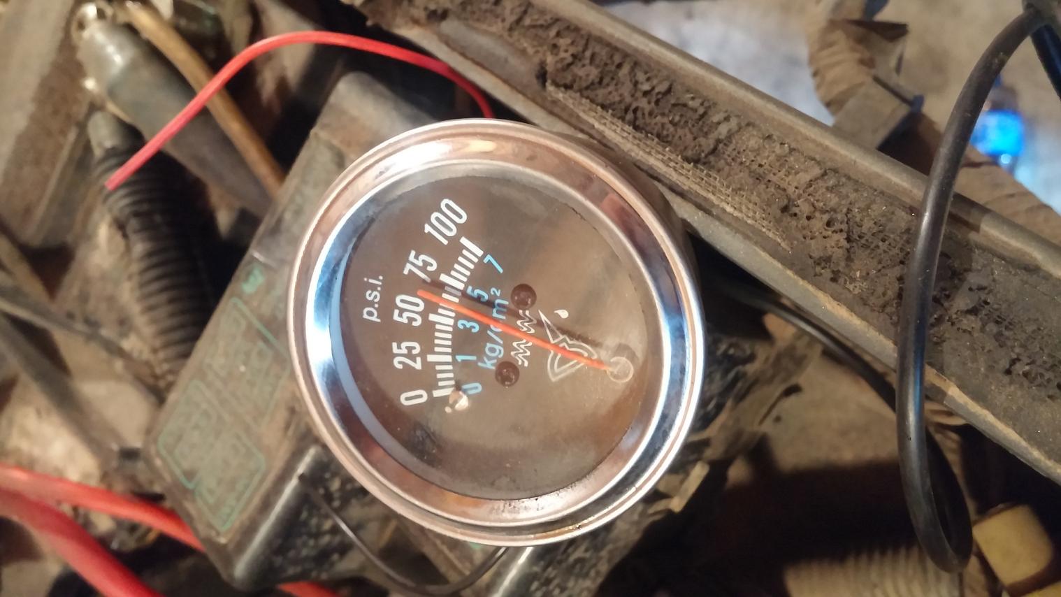

And there we have it.. Looks like good pressure to me. I'll drop the $40 for a new sensor and I think that should do it. Now the question of replacing the pumps anyways while I'm in there or not bother and hope they last at least another 10k ...

Good to see you have pressure!
