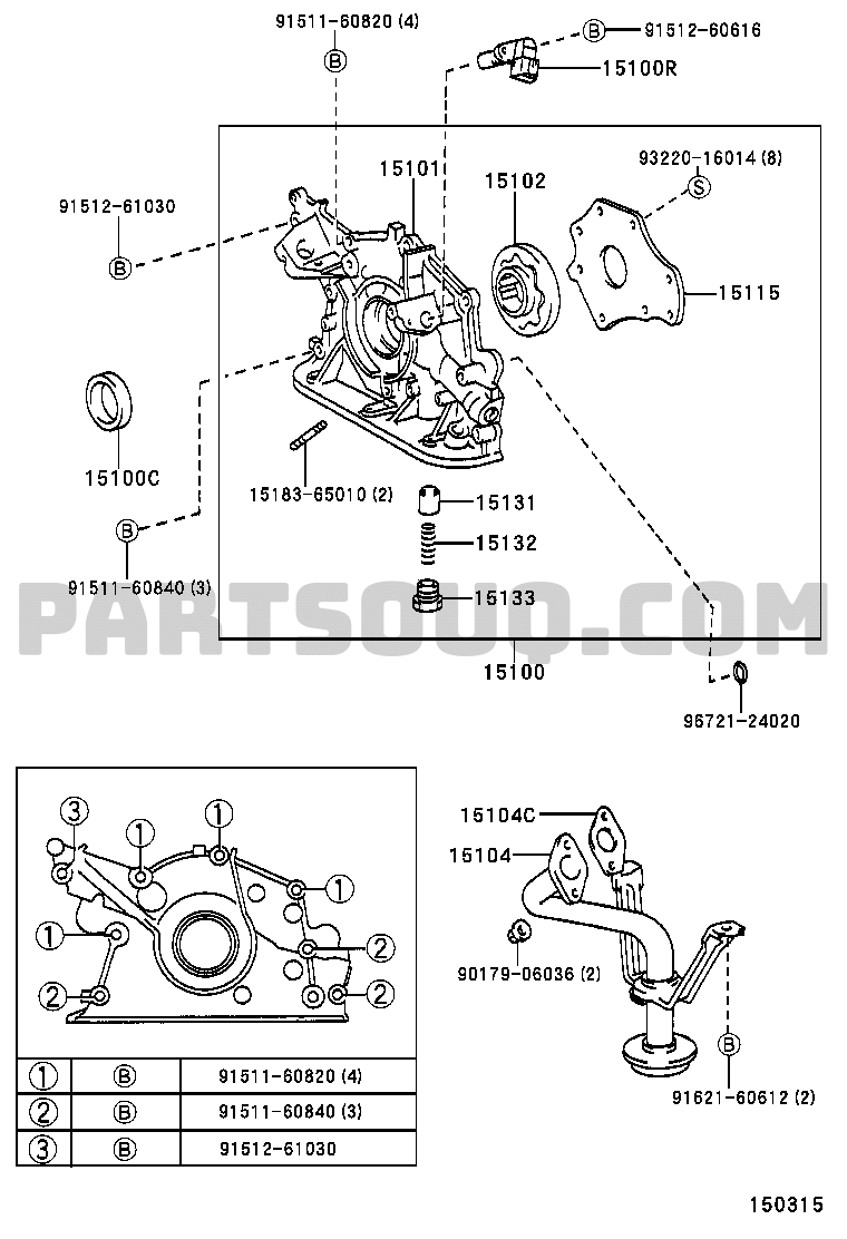

O ring
It's the O-ring (part number 96721-24020) between the pump and engine block. I too have the same issue and it leaks right next to the oil pressure sending unit. Took me some time to diagnose. I decided to leave it alone as it needs the timing belt and sprocket to come off to pull the oil pump out.
I might try conventional oil instead of fully synthetic oil on the next oil change.
O ring is shown at 96721-24020
I do not know why the 3rd gen drains your money: Mine is trouble free other than this oil leak.
