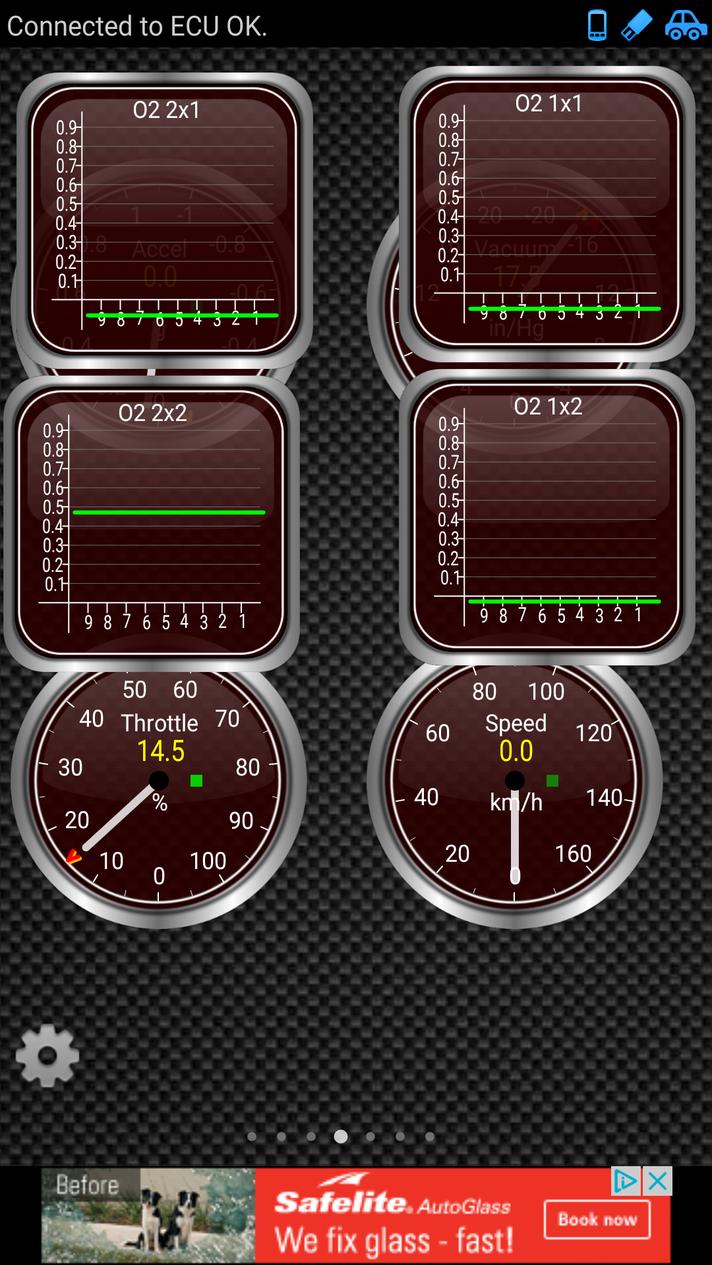

The code that keeps coming up lately after I cleaned all of the plugs out is p0136, downstream bank 1. You can see from the tq app, there is no signal. I'll probably start here with splicing in the solid wire. Note that I have never been able to get an upstream graph to work with tq.

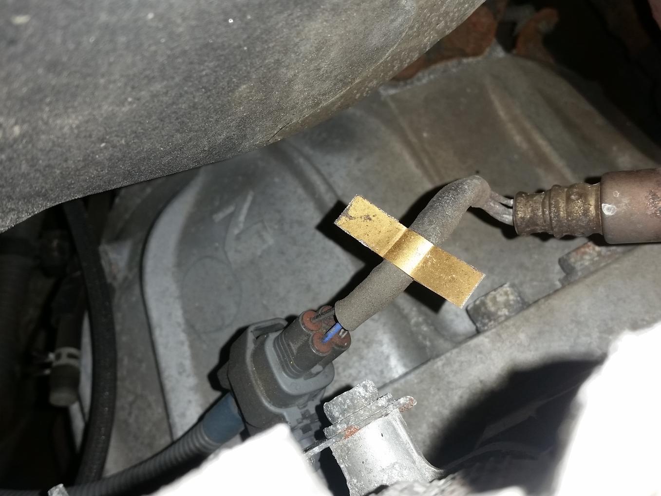

long over due update
sorry this is so delayed. (I didn't realize you guys had kept this alive until I got an email update about a PM this morning)
This has to be one of the oddest things I've encountered in my time wrenching.
I've been fighting this with no good solution.
Typically my CEL would come on, along with VSC etc.
When I pull the codes they indicate the one or both rear 02 sensors
Knowing the situation with my car and the fluid wicking…
I change my 02 sensors (both rears) and spray electrical cleaner in the ECU connectors under the glove box.
Then i reset the check engine light, and also do a zero point calibration (to eliminate the VSC stuff).
This process usually last me about a year, and I can get o2 sensors for under 100 online each.

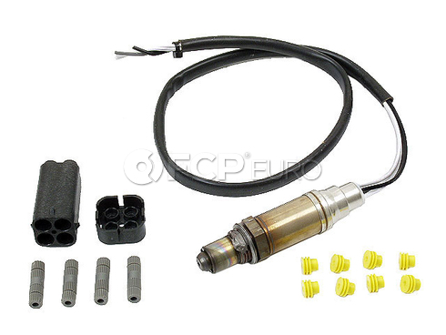

But I have changed my approach a bit this last time. Instead of OEM style 02 sensors I used Bosch universal fit sensors bc they create another connection point for the fluid to have to pass through (effectively another plug in the system). I don't know if this will help or not… I've only been running this way for about a month.
I'm not sure this will address the issue because I think it is in the connection at the computer where the fluid is causing your malfunction that sets off the trouble code. My understanding is the sensor is 'downstream' and not physically contaminated by the transmission fluid.

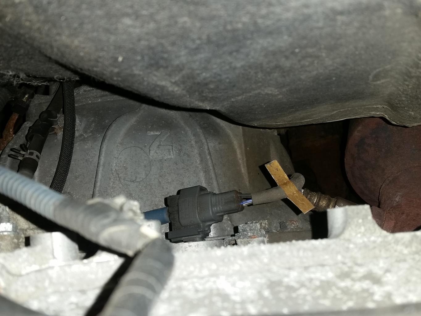

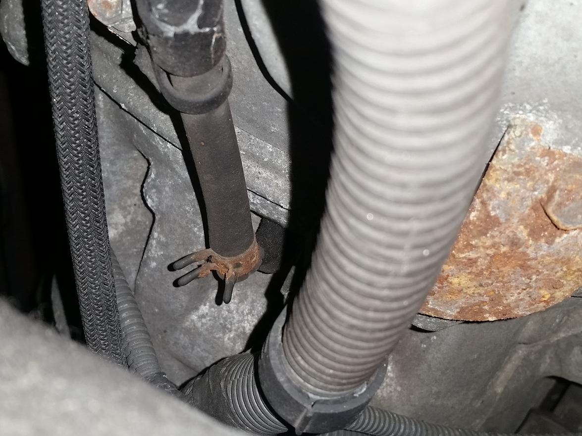

Ok so I'm pretty sure I found the transmission breather. In the pics I'm pretty sure it's the rubber hose (left side of pics) with squeeze clamps and what looks like a plug in the end. I got the pics by sticking my phone behind the motor from the engine bay. Can't really access it from below. Still not sure how to access it from up top either.
hmm, if thats the case, it sounds like a routine maintence of cleanign the ECU plugs might be the best bet (considering it only takes about 15 minutes to do.
maybe a thin sponge or paper towel in the plug at the ECU to "soak" up the fluid.?
