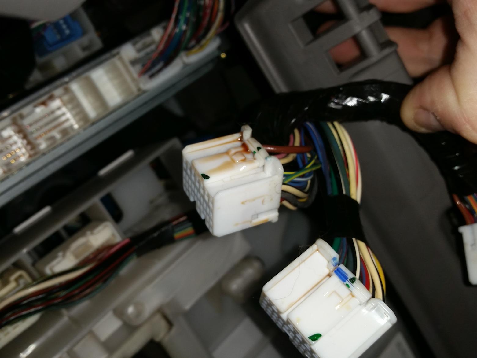

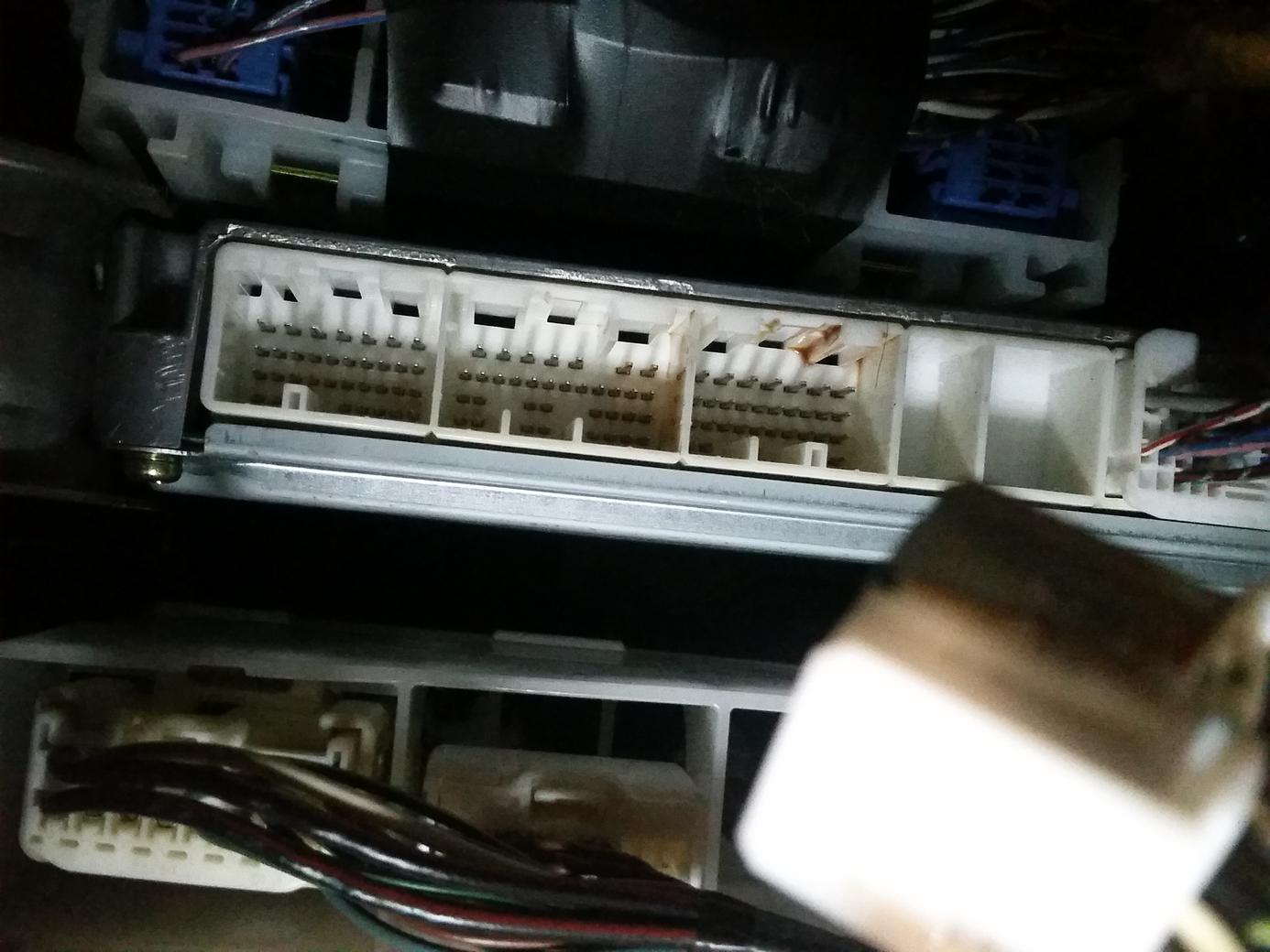

Alright, so I have been chasing down 02 codes and lean codes (p0174, p0171, p0136) for over a year. Replaced both downstream 02 sensors, a/f relay, and all general tune up stuff (plugs, cleaned maf, pcv, tb clean). The codes would always come back....sometimes not all 3 at once.
A deep Google search last night and I came across this oil in wire harness phenomenon. A light bulb clicked and I remembered last year while replacing one of the 02 sensors, there was moisture in the plug. So sure enough today, I pulled the top 3 plugs from the ecm and there was red-brown oil on the second and third plug.

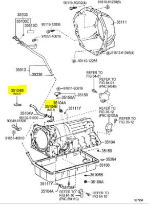

This link shows the sensor in the transmisison pan may be the culprit https://www.justanswer.com/toyota/6xjis-toyota-4runner-sr5-2003-4runner-chronic.html.
I think I have a solution to the A/F sensors failing. I am now pretty confident that the problem was transmission fluid wicking through the wiring harness from the transmission sensor to A/F sensors (including between connectors in the ECM behind the glove box). I replaced the failed A/F sensors with new sensors, but before I installed them I spliced in a piece of solid wire in each of the four conductors. The theory was that this would block the transmission fluid that was wicking through the braided wire. I did this about 1.5 years ago and have not had a problem since. Prior to this fix, the A/F sensors were failing in just a few weeks after installing. I also preformed this fix to one of the downstream O2 sensors that failed. I used high quality sealed but splices to splice in the solid wire segments (http://www.mcmaster.com/#9895k11/=tbr293).
you can also check the transmission ventilation if not plugged, as this will cause high pressure in the tranny case.

Thanks for mentioning the transmission vent, that was mentioned in the other thread. I should probably check that first.
Where is the transmission vent located? Might just be a lazy question, but before crawling under it I want to know what to look for.

Is the transmission vent on top of the bell housing? I couldn't find a definitive location for it.
Thinking back, my trans pan gasket had been leaking. I did replace it, but wonder if it's linked to a plugged vent and over pressurizing.
The vent is on top of the bell housing and comes up and is attached to the rear of the driver side head. At least on my 2008 it is.
So yesterday I pulled all the ECM plugs, and both downstream 02 sensor plugs. Both downstream sensor plugs had ATF in them, in particular the passenger side was the worst. I wiped them out, used compressed air and electrical cleaner. Unfortunately within 10 miles the code came back on (P0171, P0174, P0136).
After the drive I pulled the ECM plugs and didn't notice fluid on them, maybe a little, but could have been residual.
I suppose next steps will be to first check the 02 plugs again to see if fluid already filled back up. Along with that I'll pull the ecm out completely to make sure no oil is inside of it. I also need to locate and check the transmission breather.
