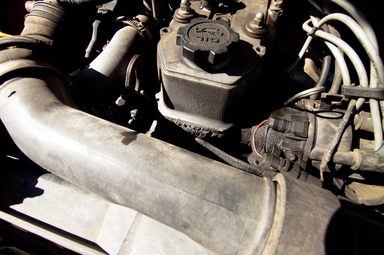

I'm looking at purchasing a 1986 4Runner. Manual. 4 cylinder. The truck appears to be in great condition, but I noticed a lot of oily buildup around the valve cover and distributor. The guy who is selling suggested there was an AC refrigerant sight glass there and that the gasket around that sight glass often leaks. Does that sound legit?
here's a photo.
At least take her for a test drive and see how she sounds/feels.
Does oil build-up go all the way around the valve cover gasket? If it does, it's normal after 26 years. Expect oily deposits on spark plugs from oil seeping into into the threads.
Consider SparkplugsDotcom for replacement parts. Good brands, good prices, quick shipping
As for leaking sight glass, When was A/C last charged? Is it working OK?
Consider how much would it cost to have leaky sight glass fixed.

I don't think I've ever seen a 22re with more than 10,000 miles on it that doesn't have that residue there between the valve cover and timing chain cover. If it's not thick and wet, I wouldn't worry about it.
