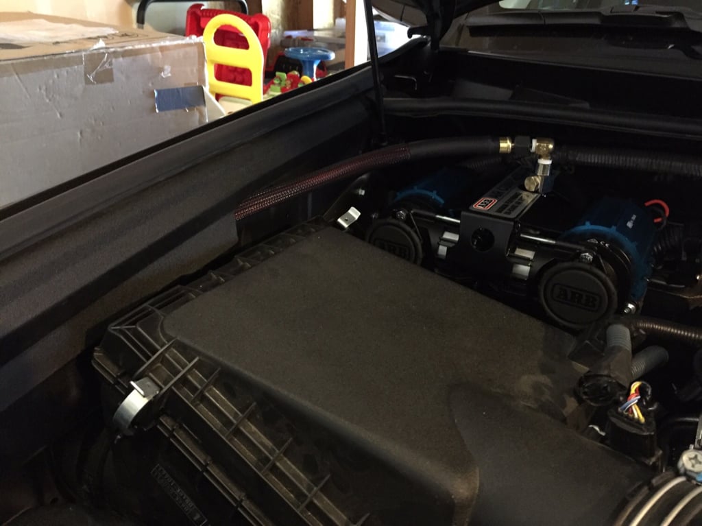

I have the CKMTA12 and that gets hot. You may want to consider a hose that is heat resistant. I ended up getting the ARB Pump Up (Inflation) Kit. It comes with the hose and also the quick release coupler attachment which is needed to connect hose to compressor.

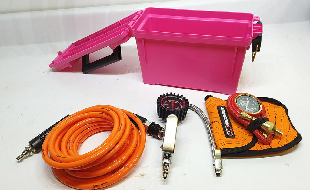

Here's what I did:
Hefty fabworks bracket
Pump up kit
Deflator and inflators

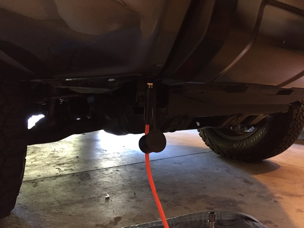

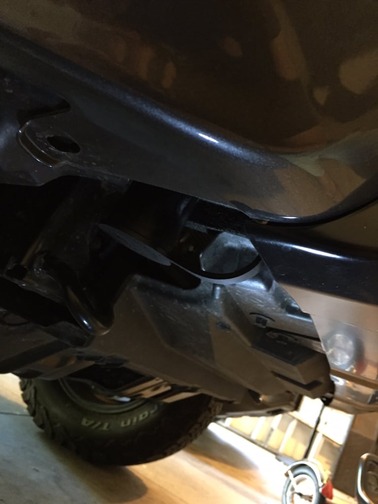

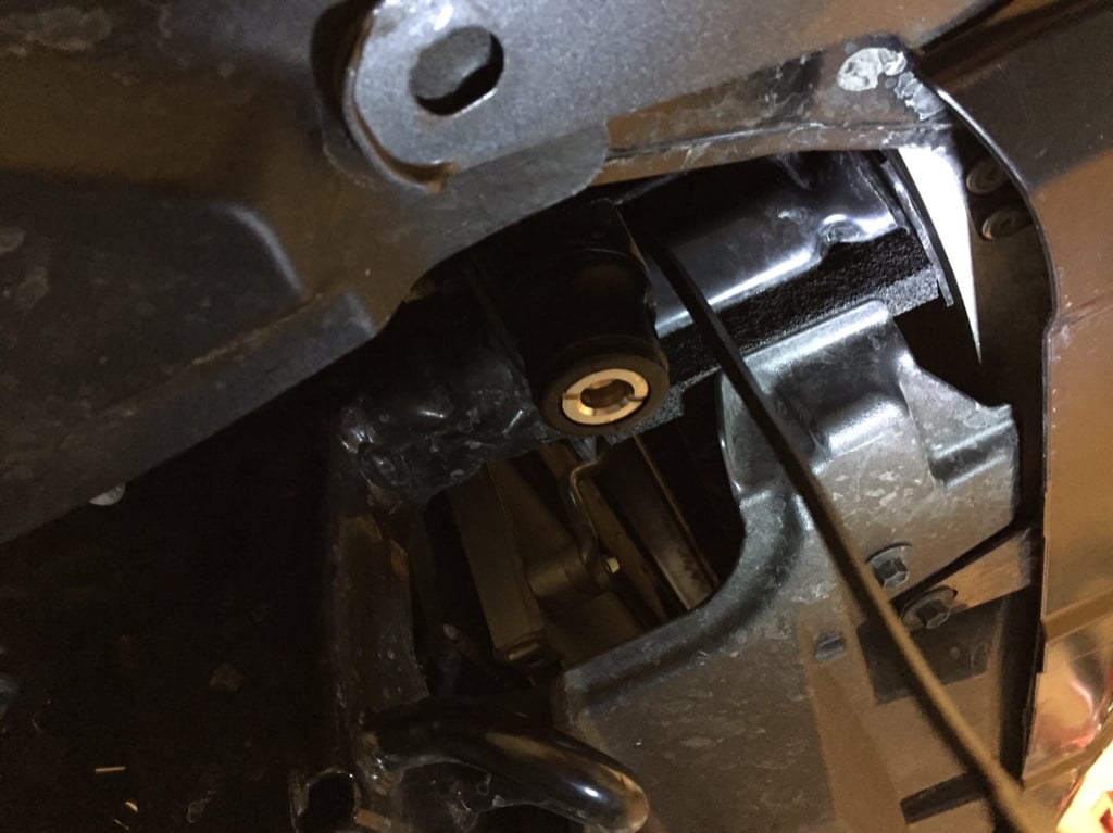

Remote mounted outlet so I don't have to open the hood

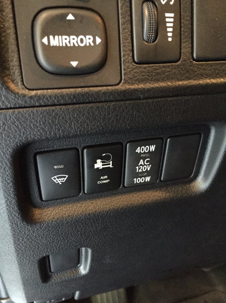

AOS factory style switch

that external connection is s very nice touch to a good looking install
