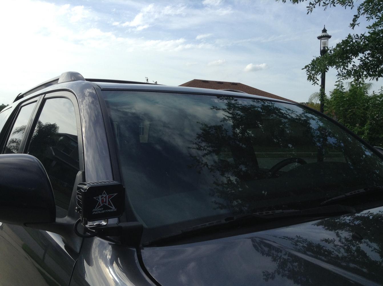

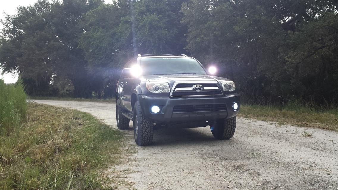

Got some Dually D2's wired up yesterday on CBI ditch brackets. They are in a driving pattern. All told it was a pretty expensive little mod, but Rigids are worth every penny IMO. These suckers are bright! The blue-ish hue from my 8k HID low beams are completely washed away by glorious white light whenever I turn these bad boys on.
I used an OTTRAW switch and put it in the center console. Since I had the console pulled apart I also installed switches for a light bar and reverse lights (future mods to be installed once I get a roof rack). All three switches are installed where the factory seat heaters switches would normally be. Being an SR5 no switches were there, so now at least the space is being used for some functional purpose and they look awesome to boot.
I know that most can't justify spending nearly $400 for the D2's, but trust me they're definitely worthy of the spend. I can only imagine the extreme white out that a full 40" Rigid light bar might create.

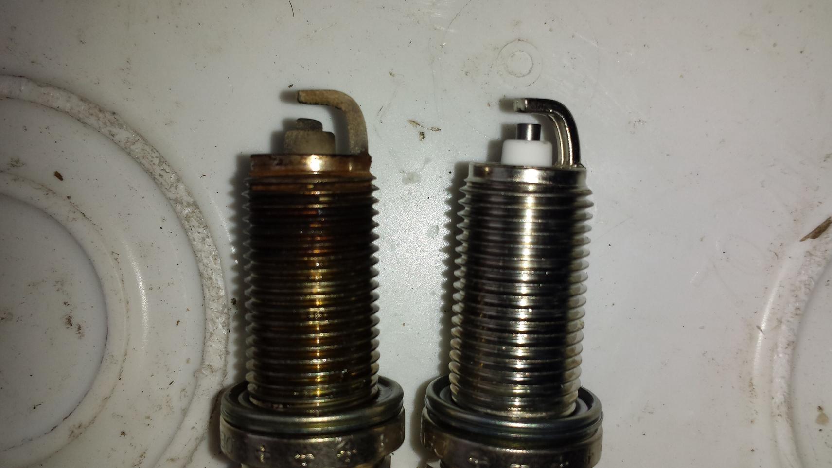

A fresh set of Denso spark plugs makes a world of difference. The originals had 117,500 miles on them. Right off the bat I noticed an increase in power, I can spin my 33's all the way through first gear :lookout: Definitely couldn't do that before . I can't wait to see how much my gas mileage improves. Right now I am averaging just under 17 mugs.
Sounds like the mileage may be getting worse. ;-). I need to look into changing mine I suppose. The picture you show illustrates the difference in gap from the years of miles of usage. There must be some efficiency gained by swapping them out. Although mine still purs like a kitten with 144k on the clock, assuming on the original set.

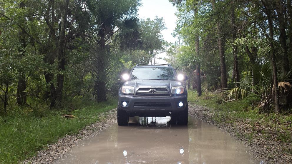

Had a fun weekend out at Bull Lake Wildlife Preserve. Lots of puddles to splash around in!

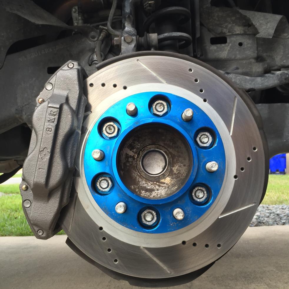

New brakes!
It's been a while since Old Grey received any noteworthy upgrades. After roughly 30,000 miles of mixed city/highway driving, the EBC green stuff pads were toast. With about 130,000 on the odometer now I figured it was also time for new rotors and some fresh brake fluid. For the fronts I decided to go with PowerStop cross-drilled and slotted rotors and they came with ceramic pads. In. the the rear I decided to keep it simple and went with a pair of rotors from O'Reillys with ceramic pads. I am really hoping that the ceramics dust less than my EBC pads. I am pretty tired of my rims constantly being dirty.
During the install I noticed that the front passenger caliper was frozen, just one of the four pistons refused to budge. I know this is a common issue with our trucks, but it was still frustrating nonetheless
Initial impressions are not great. For some reason I am getting a lot of vibration in the steering wheel whenever I brake around 30mph. I double checked to make sure that all bolts are nice and tight, including the Spidertrax and lug nuts. I have no idea what is causing the vibration.

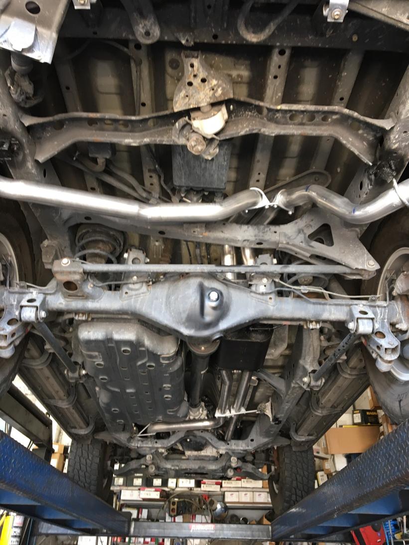

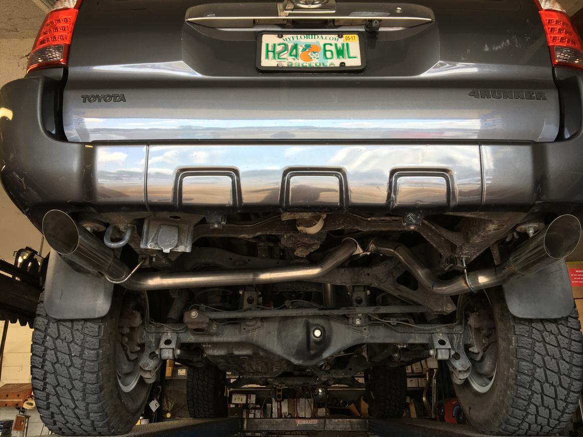

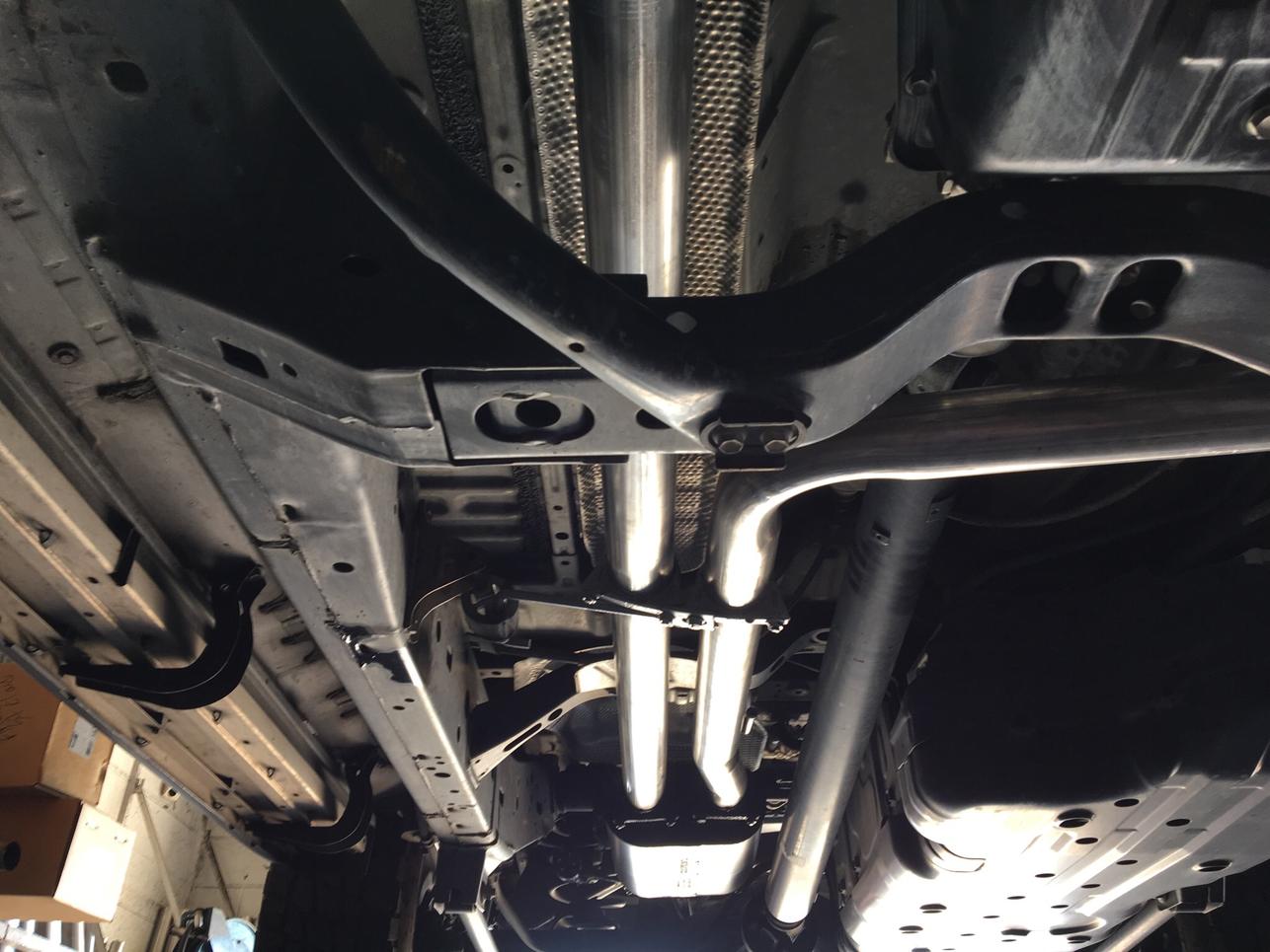

Turns out Gibson sent me the wrong parts. Luckily, Andy - the muffler shop owner specializes is creating custom exhaust systems. He spent 3 hours designing and fabricating my system from scratch. We decided to delete the two rear catalytic converters and ran piping to a single 2 in 2 out Flowmaster 50 series. I have always wanted a true dual exhaust system, so that is how we designed it. The tone at idle is perfect - low and throaty. It does get pretty loud when you step on it, but we designed the system to be heard.
