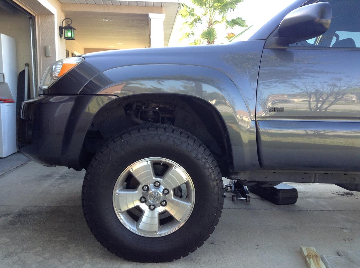

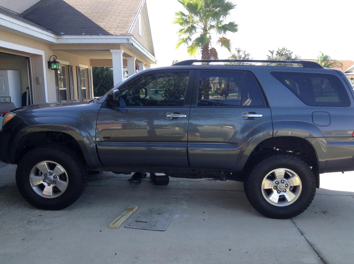

Installed the 4 Crawler 1.5" BL today. I'm not going to lie, it wasn't easy. Took me most of the day and I still have to drop the radiator and put on the steering shaft spacer tomorrow. Gotta say the rig looks awesome though.
Now sitting at 38.25" in the front and 40" in the rear. Approximately 6" higher in the front and 5" rear from the stock measurements:guitar2:

Damn it!!! 6 inches of lift and it STILL rubs. I guess the front spacers are going to have to come off. Unbelievable...
how much of your fender have you trimmed? i have 265/70's and cut a solid amount out of the front fenders and i have minimal clearance on the mudflap
I trimmed a good amount. It is rubbing on the bottom right hand corner of the wheel well, on the painted surface. I am not too keen on cutting it.

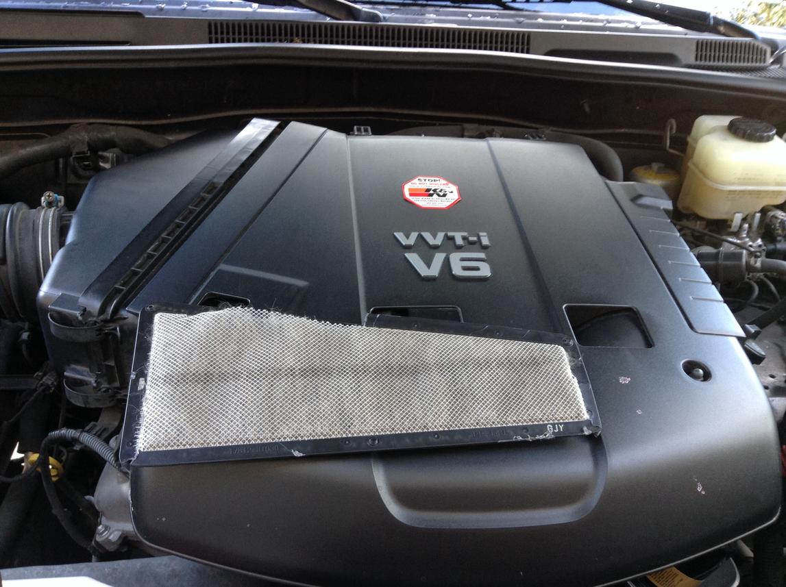

Just finished the hydrocarbon filter delete mod. I also disconnected the battery for 15 minutes to reset the ECU. Looking forward to an increase in horsepower and better mpg's!
Yep, I have roughly 4" in the front and 5" in the rear (over stock) and I still had a ton of rubbing. I cut 3" off the inner-side of the fender, in 45 deg angle, and I moved the entire liner forward about 4" using all the factory hardware. It actually looks like it should have come from the factory!
These are 285-75-16 M/T's and now I have almost 3" of lock-to-lock clearance between the tire and the fender. I also performed the body-mount chop the same day, because I know that would have been the next issue.
