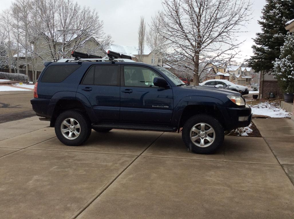

This is how she sits right now. It doesn't look so bad but the street I'm on is at a decline to.
It leans alot especially when under acceleration. Its annoying felling the rear end dip so much taking off from a stop.

Ok, if you change to a NON left/right coil like I have, just need Daystar on driver coil only. No cutting required.
Revtek spacer was a 2.5" spacer lift, I cut it to compensate driver lean with stock springs and front lift.
Stock coils are going to give you that dip feel when taking off. Soft coils. I still get a little with these springs, but, have a lot of extra weight that I have added due to aftermarket ad ons. My horse trailer and horse in it, levels my ride, but doesn't bounce around when driving. 4k +/- lbs.
