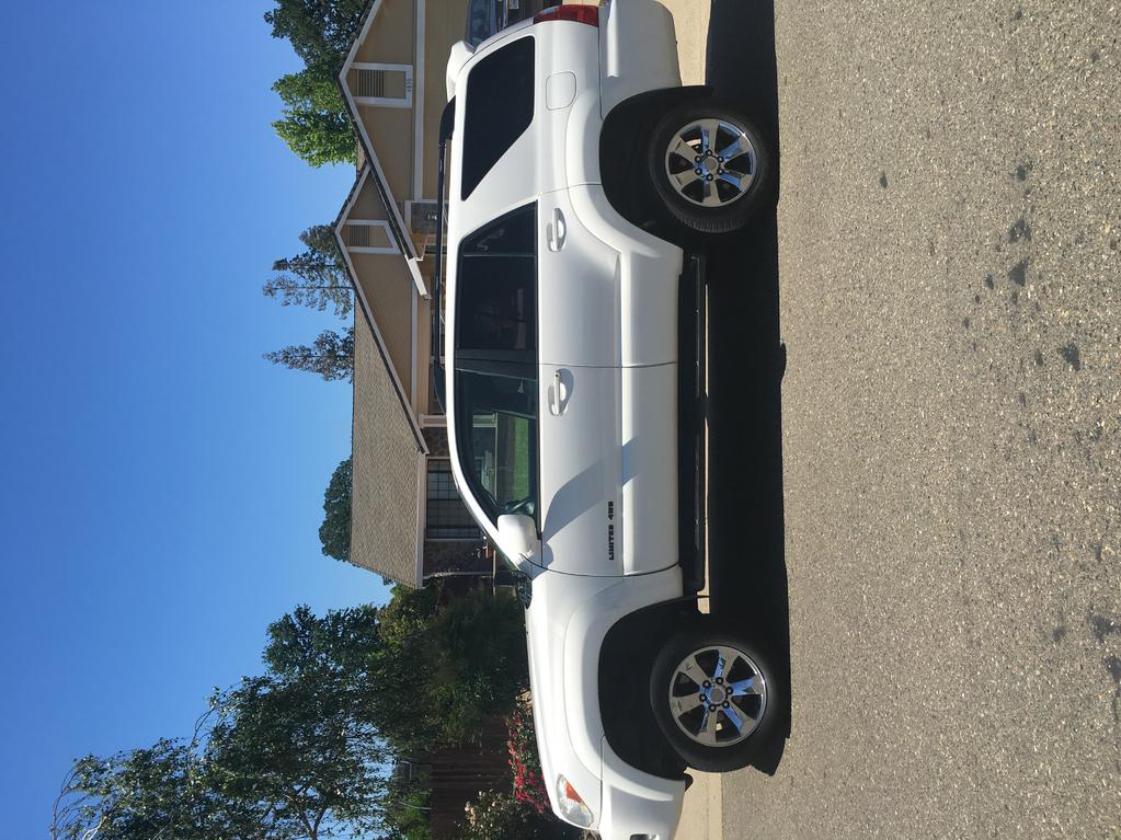

Thanks Neil for that huge piece of information on your build. I like exactly how you have it setup. Especially the air bags, I don't necessarily need them but I want them just in case. From the pictures or looks like yours is perfectly level. Do those toytec coils have a left and a right side to compensate for the drive side lean
They did not have a left and right. However, I did add the trim spacer on the front left and ended up with same fender gap in front and the same fender gap in rear. I'm very happy with the way it turned out.
I put the air bags in just in case. I definitely needed them with factory springs, but didn't need them first trip out this year. For HEAVIER loads...who knows, but I had springs out so stuffed 'em back in when I upgraded suspension.
No I honestly didn't. I only really knew of doing the spacer to fix the lean. I'm still learning about the 4runners more and more as they have more suspension components than the Tacoma. Which is what I'm used to
5100/885 set at 1.75" front and the ome hd in the rear with no weight
