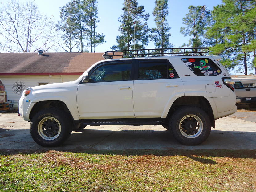

Set the fronts at 0 (bottom). The springs are good for 2" by themselves. I'm running 2" rear springs and the same 885's in the front in the picture below, with the shocks set at 0. I do have ~150 lbs of bumper and winch on the front.

Do the 885's set at 0 achieve a 2.5"+ lift if the truck didn't have a winch/steel bumper?
No, but if you set the 5100's at 0.85 they'll give you 2" + 0.85" = 2.85" of lift. Example above. calcrc tried to put his 2" taller 885's in with the shocks already set at 2.5", for a theoretical total of 4.5" of lift. It didn't want to play that way.
