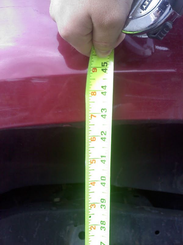

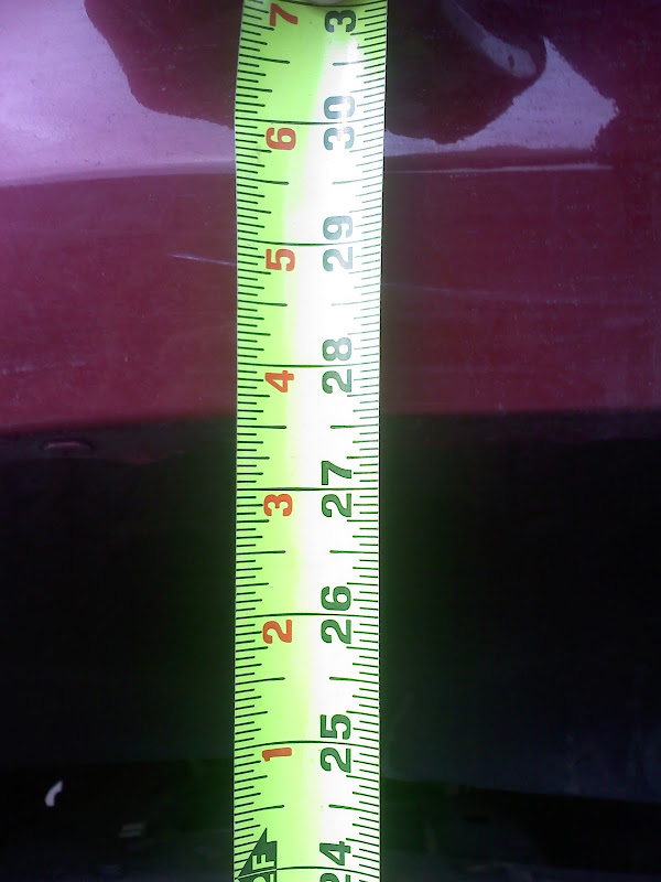

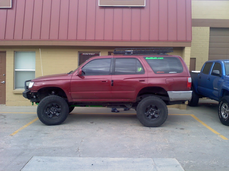

OK so here are the OME 861's on my 4Runner.
It looks like it gained 1 inch over the LC 8 wraps that were in there with ~100lbs extra weight. These are brand new coils so there will be some sag. I would estimate that these are a 5 inch coil before the spring sags. My guess is that you will end up with a 4 inch lift in the rear with some extra weight. These are not quite as soft as the LC coils but they are definietly not a stiff riding coil.
Measurment from ground to fender. OME 861's. 2 inch body lift, 285/75 BFG AT's
Measurement from center of hub to fender.
From what we can tell, these would work as a substitute for the LC 9 wraps or as a taller version of the 891. We are going to do some more testing on a 3rd gen that has more weight on the rear.
