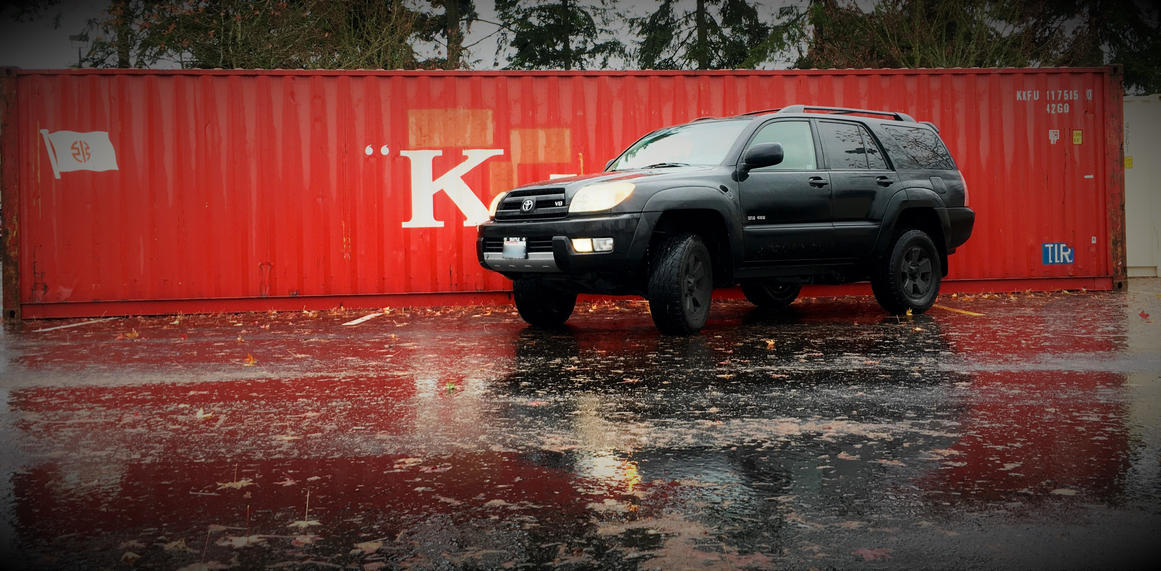

I originally had the 884 springs on the front and my truck was riding nose high. Although based off measurements, I was "level." But based off the eye test, my front was a tad bit higher. I wasn't happy with this and I swapped out for the 883 springs and now my front sits about .90'' lower than the rear.

I originally had the 884 springs on the front and my truck was riding nose high. Although based off measurements, I was "level." But based off the eye test, my front was a tad bit higher. I wasn't happy with this...

For the short time (3-4 weeks) I had my 884 w/90021 set up, I felt the ride was great. It was comfortable yet firmer than stock, and it soaked up road imperfections great.
1st picture: the 883 set up again:
2nd picture: is the 884, although its not a great picture, and the ground isn't level, and the lighting a bit dark :smash:
I like the way both look! Tough choice!
Leaning towards the 884s in the front and the 895s in the rear. Sometimes when we go through deep ruts the skid plate will scrape a bit. I reckon the extra bit of lift in the front *might* make that bit of extra difference and get that nose up a touch higher.

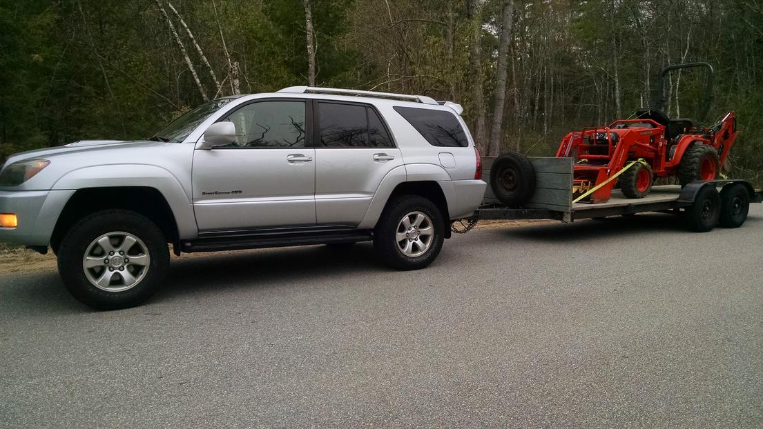

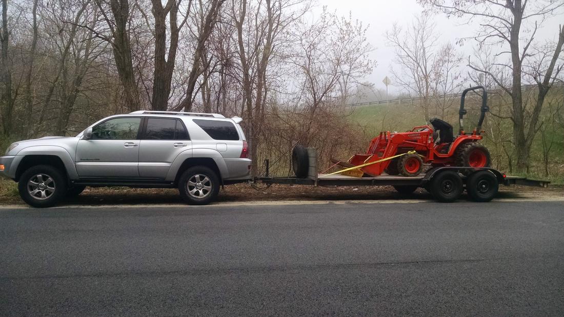

A few days late on the pics but here's an example of my loaded 4Runner. In each pic I have about 150lbs of weight in the cargo area in addition to the tractor in tow, with and without the backhoe attached
About 2" of rear sag that cannot be felt in the driver's seat.
EDIT: I don't know why, in the bottom pic, my front tire looks larger than the rear. All 4 tires are 265/70-17.
Just an illusion. More open space/negative space around the front since it is lifted whereas the rear is squatted thus preventing more space to trick your mind. That's all. Cool tractor :playball:
