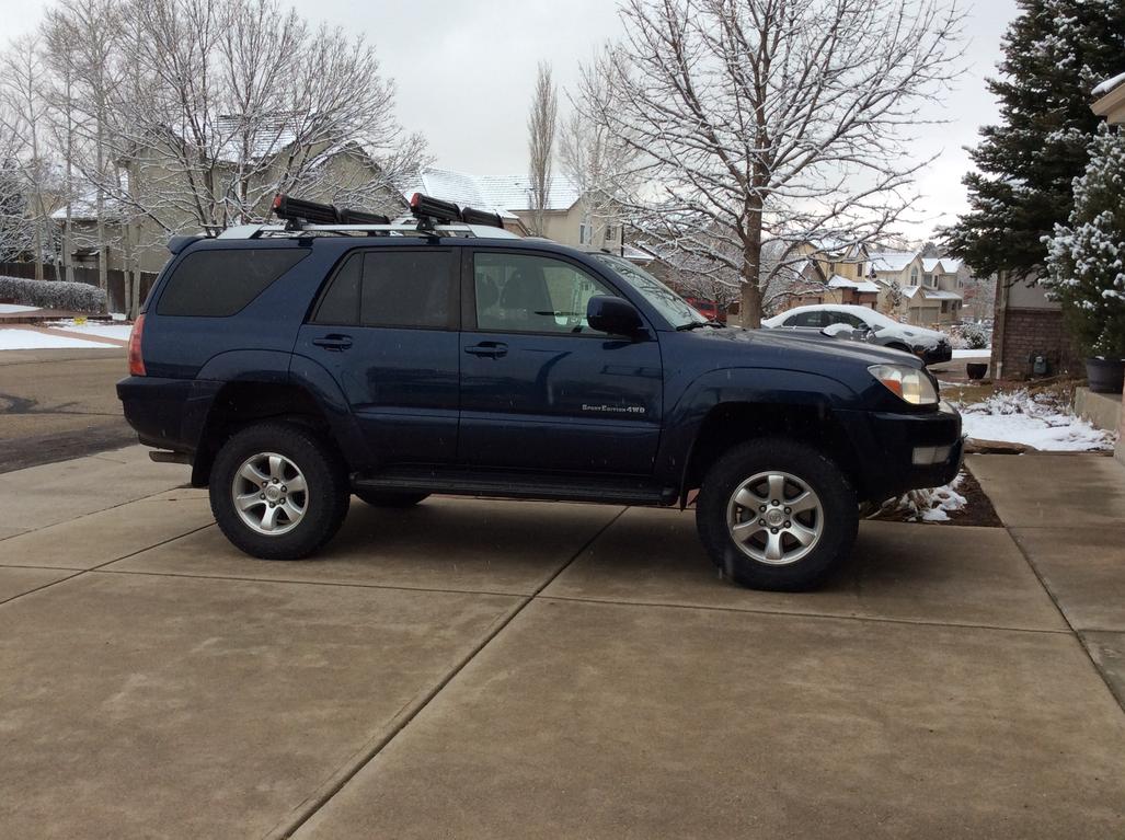

I have 883 coils on 90021 shocks in front and 895E OME coils with 90004 shocks in rear. It has a 5mm OME spacer on driver's side to keep it level. Tires are 265/70/17 Michelin MS2. Gives it a nice stance without being too tall in my opinion. Still has a little rake which I like. Originally I had xreas. The truck is a 2007 v6 4x4 sport so its the same as yours. I don't know how to post pics from another post I made so I will link to it so you can see various pics and lift height. http://www.toyota-4runner.org/2018721-post3789.html. As far as ride is concerned, it is definitely more truck like but not harsh. Even with the 90021 struts it is noticeably firmer than stock. It takes turns about as fast as xreas but with more body roll. I also have spidertrax spacers and highway tires so I don't know if that helps in cornering. When it comes to crazy pot holes and stuff it is truly unbelievable in my opinion. Currently I have 139,000 miles. I had the truck since new so I know how it rides at all mileages.

I first saw the OME lift with the 90021 front with 883 coils and 60004 rear struts with 895E rear coils on Slee offroad's website. Cristo Slee is one of the top Toyota truck overland experts in the country. He didn't have the above mentioned suspension kit in stock so I ordered it from Wheelers offroad.
DO get the driver's side spacer! Many people say they have slight driver's lean after the install. Wheeler's offroad strongly recommended I get it also.
I agree that you should go with 884 and 895 rear instead of what I have. I got the 883/895E combo because I had brand new tires that will last several years and I paid a lot for them and the truck would look ridiculous with a taller lift because of the tires. Do go with a offroadish tire like BFG ta ko2 because a passenger tire will be too small in my opinion. Personally I would go a little bigger than 265/70/17 with the 884/895 setup. Or at least a knobby tire in that size.
The 90021 front and 60004 rears already ride like an unloaded pickup truck and I have P rated tires. You are definitely not getting a squishy shock if you go with those. I have driven over very choppy roads, and in construction sites that are undriveable by a normal car and the OME suspension rode like a dream. I can not imagine what those fancy icon or king suspensions would drive like because the OME setup rode super smooth and controlled.

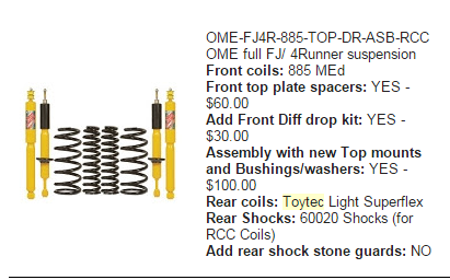

I have an 06 v6 SR5. I went with 885's + the top spacer (from toytec) because I planned on (and still plan on) installing a DO front bumper.
I opted to go with toytec rear superflex coils.
Nitro shocks all around. It sits high - I believe my measurements are 4.5 inches of lift (from center of wheel). I cleared enough for 285 / 75 / 16 without having to do any trimming or body-mount chop.
I don't know if the DO bumper will change things, but it has been a rougher ride than I anticipated.
Note my order below:

I went with a slightly modified OME/Toytec lift and its perfect IMO. I have an 04 V-8 and went with OME 895/90021 in front and a Toytec RCC2.0HD rear spring with OME 60020 in the rear. The RCC2.0HD gives an extra 1/2" lift (2 1/2) with a spring that is roughly 25% stiffer than stock. When empty it does ride stiff, but not too stiff. However, when I've got 4 passengers and gear it's perfect and my T4R rides level. When pulling a 2500 lb PUP it rode level as well without airbags. I'm now pulling a 4500 lb travel trailer with WDH and it also tides level. My .02

Nice. How much lift did you get?
It's a bit hard to say exactly 'cause I came off worn out shocks, springs and a spacer lift. My best guess is 3" in front and about 2 1/2" in back from stock. It hasnt settled much and she is still sitting at 23" from hub center to fender in front and 24 1/2" in the back. I am also running a trim spacer on drivers front which kept the numbers in front equal.
