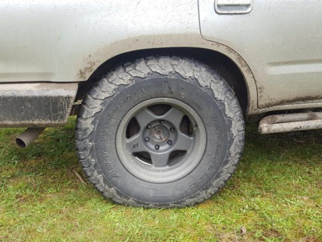

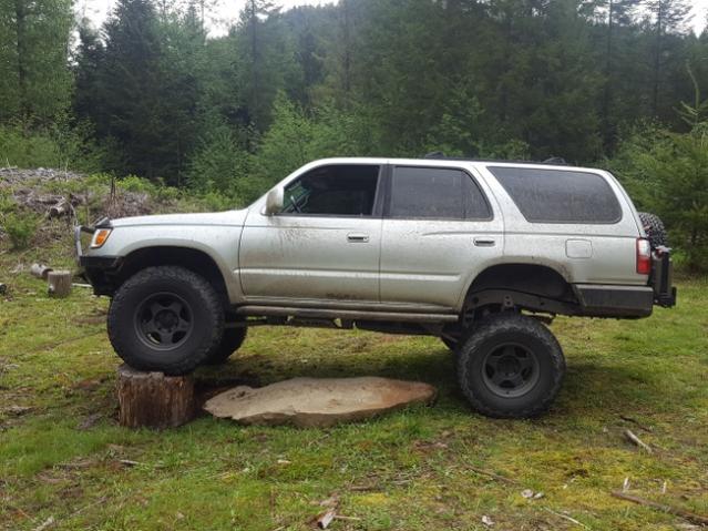

I also went from LC 7 wraps in the back ran without the OEM cone isolators to OME 861's with OEM cone isolaters.
As far as actual bump stops go, I am running the Sonoran Steel extended bump stops that are offered with his 1.2 rear lifts. They seem to work just fine. The 861's have plenty of flex. They will flex to bump stops no problem.
I would suggest putting them back in. It wont hurt anything. They may keep extra coil chatter down too.
