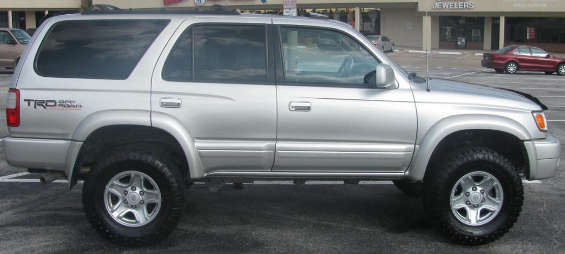

Here's mine with 881's and 906's. I also used two 10MM trim packers with my 906's, so my set-up will be slightly taller than 880's/906's. I have 265's and it looks pretty good to me.
So you did 2 trim packs on each side or just one per side?

Two on each side. I have a slight rake now and I like the stance. But remember I have 881's which are suppposed to be slightly taller (+/- half an inch) than 880's.
I am thinking 880/906's will give me what I am looking for, just not sure about spending $800 for such a mild lift. Are you running toplate spacers with your 881's?

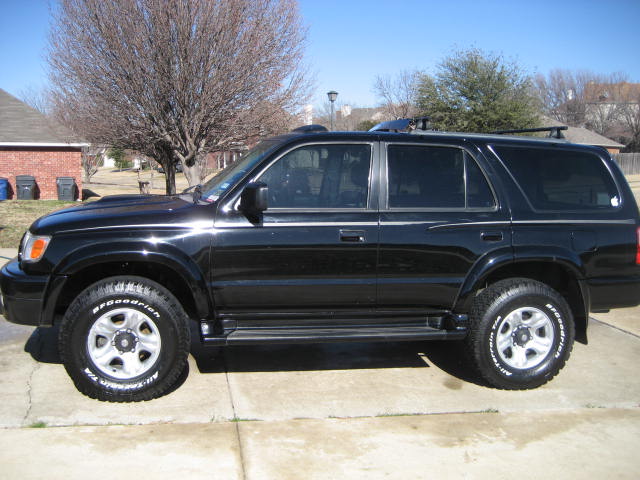

Well after hours of google pics and much debating I am going to go 881's up front no topout spacer's and 890's in the rear, I figured 880's and 906 would leave me wanting more lift. I am going to keep my 265/75/16's unless they look goofy with the 881's and 890's then I will go 285's, lift and rocksliders and a roof rack will be the last mods to this thing for awhile
That's 880/906? And, those are LT265/75s? I am looking for something equivalent to this ride height. Have you ever loaded up the rear? Sag, etc? Nice looking 4Runner!
Thanks and Yep, that's it, tires and lift. It was a good choice for how I use the vehicle. Plus at the time of install I had to be able to get it into a very short parking garage (6'2" max height). We took a trip recently with 5 people the dog, guns, fishing equipment and all of the luggage on the roof (I have a basket I use sometimes). It came down to a little higher than level and rode outstanding. Again, I chose it based on how I would use the vehicle and the trips I take. If one day that changes I will upgrade again.

Nice! That's about what I am exactly looking for. I look at it about the same way.
