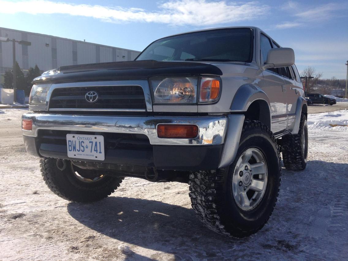

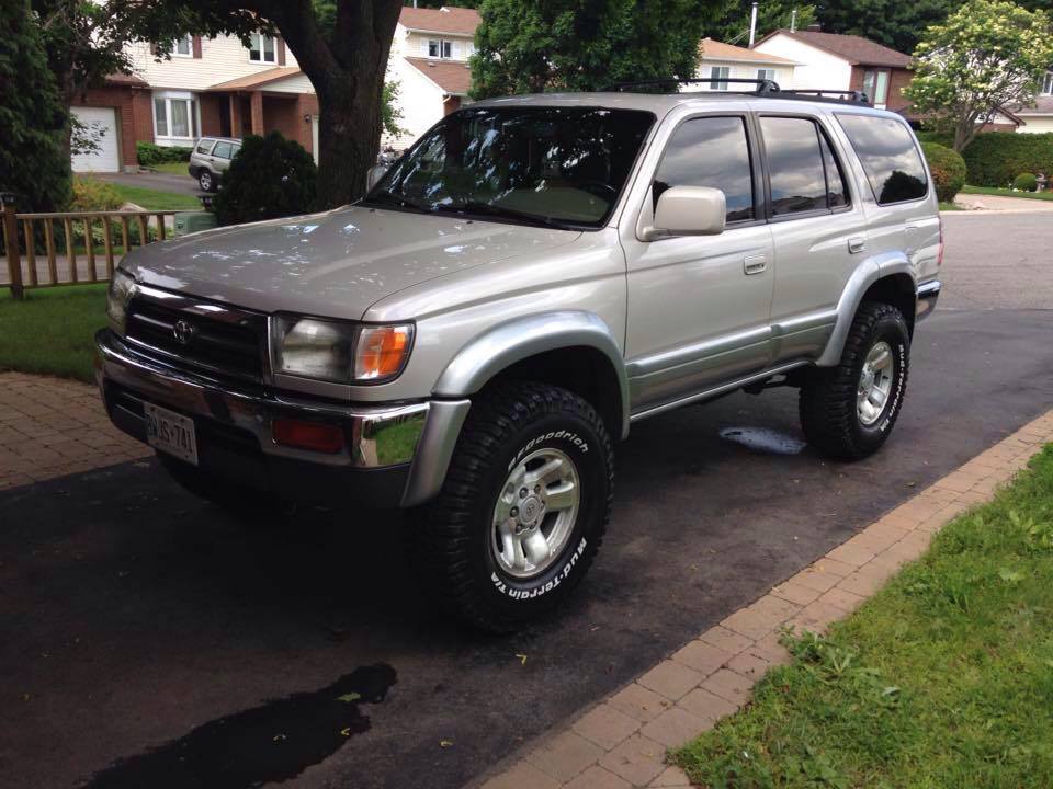

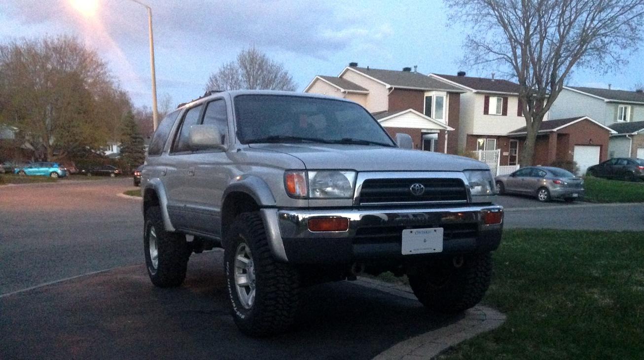

881 fronts (w/ top spacers & 1" diff drop) and 890 rears should look like this, cause that's what I have (w/ 285/75R16s)
