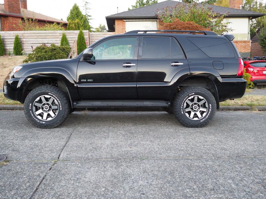

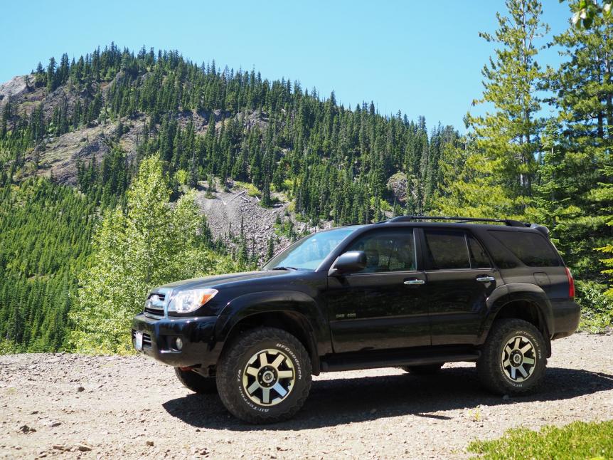

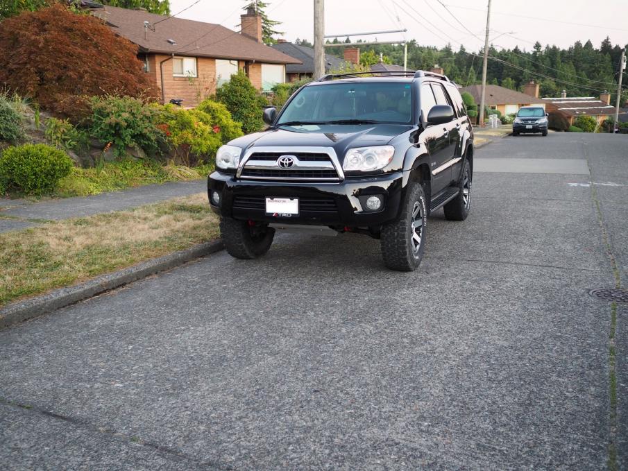

Here is the result -- 2008 V6 4Runner with OME 885/895 with nitrochargers sitting on 275/70 KO2s. Still waiting on the Victory Sliders and Rack, but happy with it so far.
