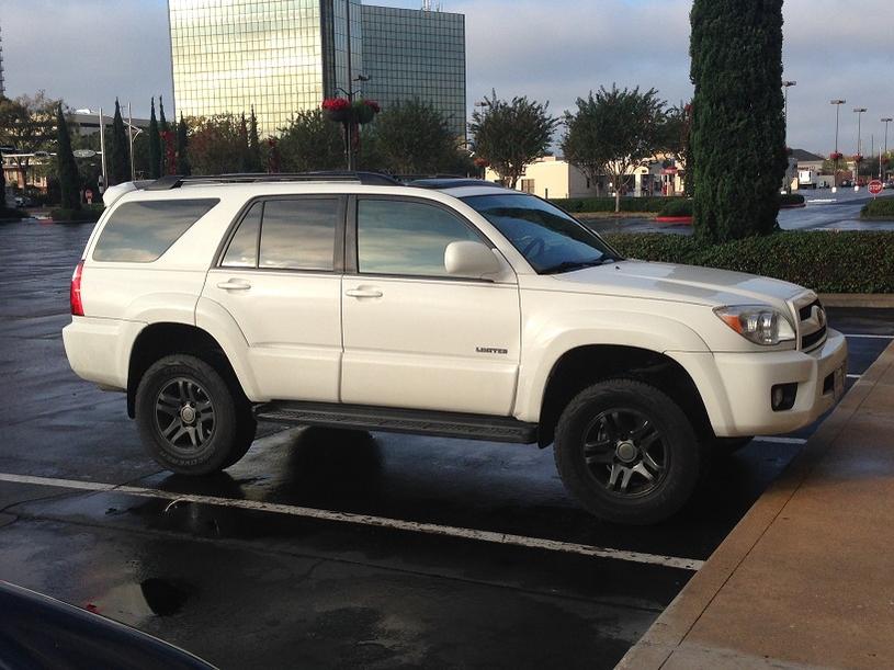

JLR, here's a pic of FJ coils with a Daystar 1.5" spacer in the back. I also have FJ coils with a top out spacer in the front - not sure how this compares to the 884s, but hopefully this gives you an idea of how high the rear will look.
Miller, keep the spacer and the spring perch on the lowest setting. Pre-loading the springs will only make them feel stiffer.

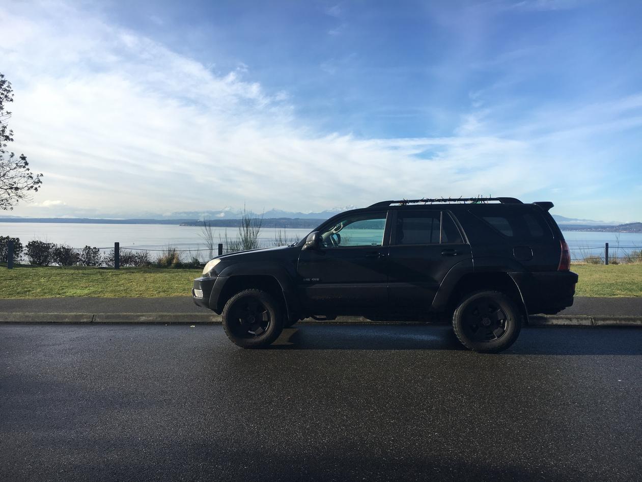

OME 884 on Bilstiens @ 0, Daystar 1.5" rear spacer. (stock rear coils) 265/70/17 tires. Second picture is 265/65
Sent from my R2D2 using Tapatalk
