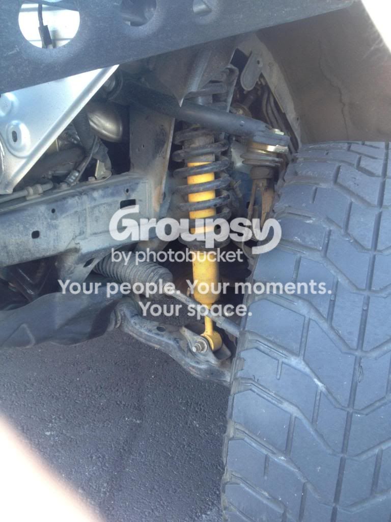

Any chance you have a picture of setup set a 0?

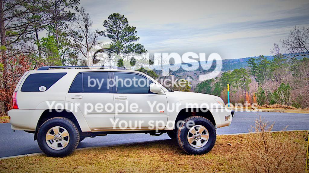

Here ya go. A lot of it has to do with how much sag your stock suspension has on it as well. That could be the main source for all the variability. Mine was sagged an inch or so below stock so that's probably why mine gave me 4 inches. Also, the higher you load your bilsteins, the stiffer your ride is going to be.

0 - .85 - 1.75 - 2.5

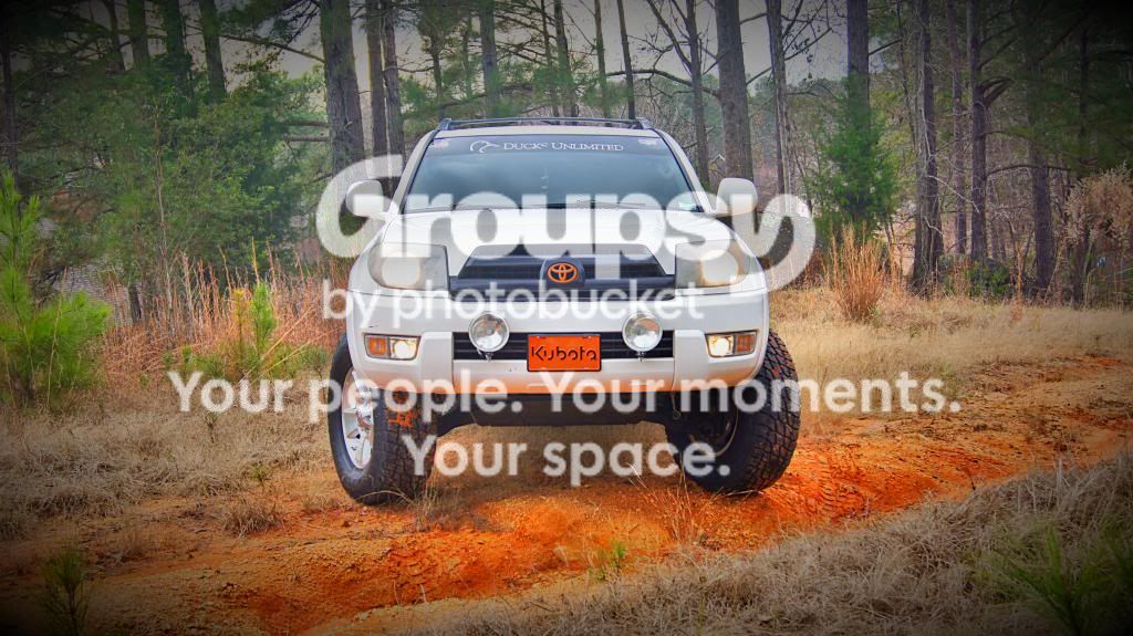

Shortly after that pic, I added a 1/2" body lift and 1/2" net lift spacers. I was right at 4" lift with this setup. I ran 285/70/17 Duratracs, and I had to add wheel spacers to clear the upper control arms. I had to remove the front mud flaps and do a good bit of trimming, still rubbed occasionally. Only issue is that at over 3" lift, you may have trouble getting the alignment into spec unless you add aftermarket UCAS. I'd suggest sticking with the lowest setting and adding a 1"-1.5" body lift for extra clearance and to avoid alignment issues.
